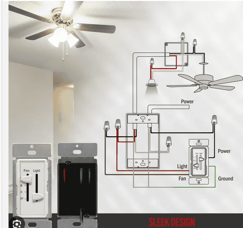

I'm not exactly sure about that. If it's the usual circuitry often used for cheap cooling fans then the high speed will be a direct connection, while the low speed would be through a cap. In such case linking them up won't cause harm.
A check on the actual circuitry would help a lot.
But, if the fan is for such use (with a remote switch), then there should be a wiring diagram somewhere, no?
And if it's not for this, then you just shouldn't, right?
...example:

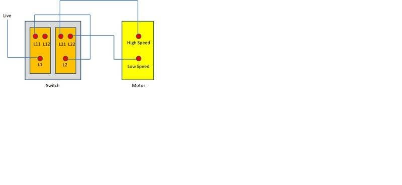

Let me formulate the problem clearly.
I want to use a 2-way-2-gang switch to control a dual-speed fan motor. The switch has six poles on the back: L11, L1, L12, L21, L2 & L22. The motor has two terminals: High Speed and Low Speed. The idea: switch L1 is for overall On and Off and switch L2 is for selection of two speeds.
My connection looks like this:
External L line -> L1
L11 -> L2
L21 -> High Speed terminal of the motor
L22 -> Low Speed terminal of the motor
Is it so far correct? Do I miss something?
This is my wiring diagram.

I can also find such two speed switches on the market, but I’d prefer my 2-way-2-gang switch because I need a squared switch panel. So does my wiring work at all?
It looks okay to me. You might want to show the Neutral connection as well, but I'm assuming that it just goes straight through the junction box to the fan.
Don't forget safety earth-bonding to the box and, unless device double-insulated, to that, too...
