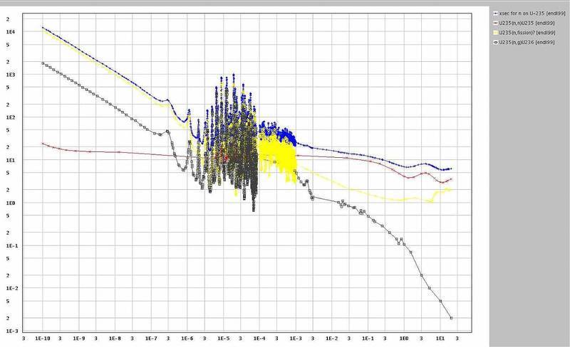

Nothing below U-233 is readily fissionable by low to intermediate energy neutron absorption.
Pa-231 is fissile with thermal and epithermal neutrons, but has a very low cross-section < 1b, and more on the order of 1-100 mb. Th-232 is effectively fissionable with fast neutrons only, >1 MeV and higher.
http://oldserver.ba.infn.it/~ntof/proposte/TH_PROPv7.pdf
Pu-241 has a half-life of 14.290 y and is fissile. The isotope Americium-241 (which results from the 14-year half-life decay of Pu-241 which accumulates in reactor grade plutonium with increasing burnup) emits highly penetrating gamma rays, increasing the radioactive exposure of any personnel handling the material.
See Morbius's discussion of 'fissionable' vs 'fissile'.

Many fission products already decay rapidly. It's the longer living isotopes which present a problem, e.g. Cs-137 and Sr-90, but these decay with about about 29-30 year half-life.
http://www.nndc.bnl.gov/chart/ - one can select a section and zoom in on the appropriate radionuclide.
Any nucleus can be 'transmuted' into a new isotope by neutron capture, and that is one reason nuclear fuel has to be periodically removed from a reactor - the fission producst compete with the fissile material for neutrons - and isotopes of Xe and Kr build up causing pressurization of the fuel and swelling of the ceramic or metal matrix.
