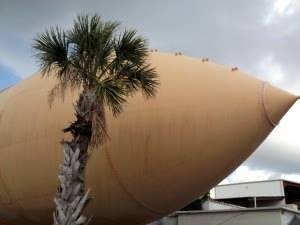

yrjosmiel73 said:
Volume is not very much a problem.
In that case, I have a great bargain for you. A tank suitable for your gaseous O2 oxidizer sits unused and abandoned in Green Cove Springs, Florida. It was built for the NASA space shuttle. Make them a reasonable offer. :wink:
