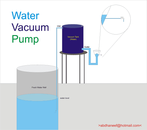

can it is possible to build or make a water pump like this
http://forums.about.com/n/docs/docDownload.aspx?webtag=ab-physics&guid=435b1342-00eb-4166-a03b-97355a063e9c
pls help me on this......
can anyone give me a better drawing of this with meausrments.
my email is abdhaneef@hotmail.com
abdulla haneef
If you want the water to flow into the tank, the inlet should be no more than about 10 meters above the outlet, because a column of water of that height will have the same pressure as the air pressure. To get water out of the tank you better have a way to make the vacuum disappear.
No to get water to flow the outlet from the tap needs to be below the water level in the lower tank.
