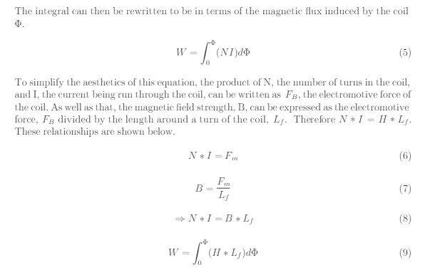

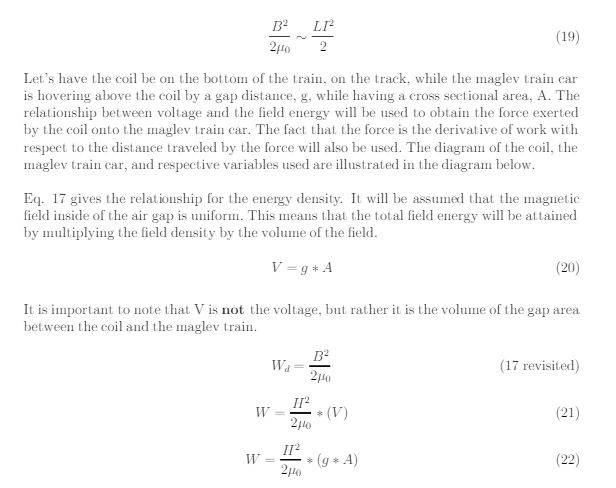

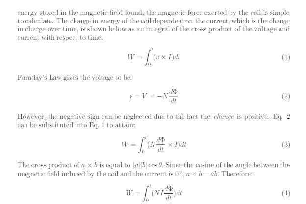

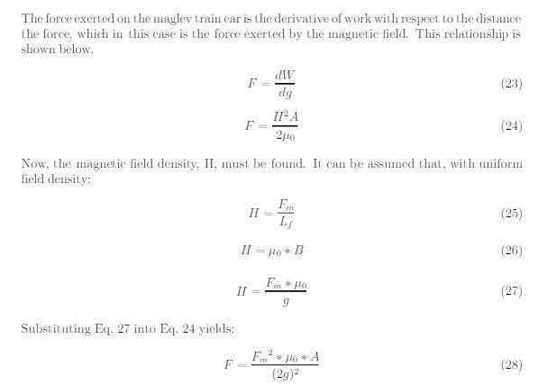

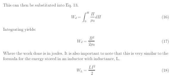

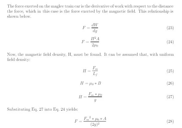

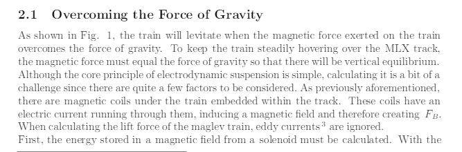

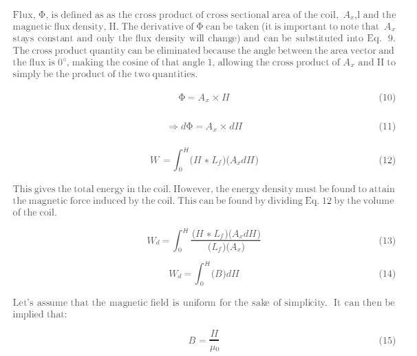

After a week of desperate searching, I've come across this document (on https://www.academia.edu/34876525/Magnetic_Levitation_Transportation) that shows a series of calculations that are perfect for my assignment. They are under the section "Overcoming the force of gravity" at pages 8-12. Although, I get lost around the sixth equation because I'm not sure the procedure is legit. What do you think?
I'm posting the screenshots of the calculations

Which part are you following okay, and what part is tripping you up?
I am now able to follow till the 24th passage. The only thing I'm not getting it's this costant switch between B and H, what's their difference? And also why at the 25th equation we have two forces?
Do you mean equation 24? If so, can you describe your understanding up to that point, and what confuses you? B versus H usually involves the material that the magnetic field is in:
##B = \mu H##
so you will likely see H for non-ferrous regions and B for the field in a ferrous material.
Actually, after some efforts and thanks to your heads up, I was able to rewrite all the equations in the way I needed, so I'd say "problem solved". Thank you for the support, guidance and patience
