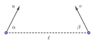

Two identical particles with velocities u and v, which form angles α and β with the straight line that joins them, are at a distance l from each other. The charge of each particle is q. Determine the mass of the particles, knowing that the minimum distance between the two is X. Despise the gravitational interaction.
mv^2 /2
kq^2 /d
I can only say that:
mv^2 /2 + mu^2 / 2 + kq^2 / L = kq^2 /X
Yes or not and why?

Are you familiar with reducing a two-body problem with a central force to a one-body problem with a reduced mass ##\mu##? For example, see this .
It seems to me that you will be able to find only the reduced mass. You won't be able to find the individual masses of the two particles.
That would be true if they were stationary at closest approach. Will that be so?
It says they are identical...
