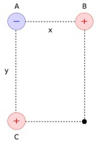

In the figure above, charge A is -5.00 nC, charge B is 10.0 nC, and charge C is 5.00 nC. If x = 2.10 cm and y = 4.20 cm, what is the electric field at the dot?
E = kq/r^2
r = distance from A to point = sqrt(x^2+y^2)
Ea = kq/r^2 = -20'414.6 N/C
Ec = kq/x^2 = 102'040.8 N/C
Eb = kq/y^2 = 51'020.4 N/C
Eax = -20'414.6cos63.4 = -9'140.8 N/C
Eay = -20'414.6sin63.4 = -18'253.8 N/C
Enetx = Eax-Ec = -111'181.6 N/C
Enety = Eay-Eb = -69'274.2 N/C
Enet = sqrt[(-111'181.6)^2 + (-69'274.2)^2]
theta = tan^-1(Enety/Enetx) = 32 degrees
Final Answer (which was wrong): 1.13x10^5 @ 32 clockwise from horizontal
Can anyone tell me where I went wrong? Supposedly there is a special formula that I am supposed to use to find the components but I have never seen/used it before.

shadowdn said:
Enetx = Eax-Ec
You calculated the individual contributions all on the basis of right and down are positive. So why are you performing a subtraction to find their sum?
Also, please get into the habit of working purely symbolically, not plugging in numbers until the end. It has many advantages, including making your work much easier to follow and verify.
