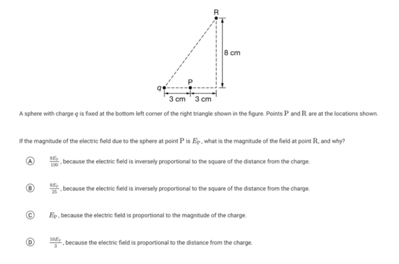

Problem attached below.
E = kq/r^2
I've no idea how to solve this problem. The sign of the charge is not mentioned, so I'm assuming the charge is "+". The charge exerts an outward electric field. Since two lengths of the right-angle triangle are given, I use the Pythagorean to find the hypotenuse, which is the distance between q and R, and it's found to be 10m.
$$ E = \frac{kq}{r^2}$$
$$ E = \frac{kq} {100}$$
I'm wondering why all the options have ##E_p## in the equation since it asks only for the magnitude of the field for point R. It would be great if anyone could explain how to solve this one.

write expressions for the fields at points P and R in terms of q.

ok.
The electric field at point R is
$$ E_{R} = \frac{kq}{100}$$
The electric field at point P is
$$ E_{p} = \frac {kq}{9}$$
$$ 9\times E_{P} = kq$$
$$ 9\times E_{P} = E_R \times 100$$
$$ E_R = \frac {9 E_P} {100}$$
Is it right?

These are wrong because you used centimeters in your calculations.
But final answer is ok since here we calculate the ratio.

Thank you for pointing out @MatinSAR. I edited it. Does it look ok now?
$$ E_{R} = \frac{kq}{100 \times 10^{-4}}$$
$$ E_{p} = \frac {kq}{9 \times 10^{-4}}$$
The ratio of ##\frac{E_P}{E_R}## gives,
paulimerci said:
$$ 9\times 10^{-4} E_{P} = kq$$
$$ 9\times 10^{-4} E_{P} = E_R \times 100 \times 10^{-4}$$
@paulimerci Yes, It's correct now.An easier way:
##\frac {E_R}{E_P}=\frac {\frac {kq}{r_R^2}}{\frac {kq}{r_P^2}}=(\frac {r_P}{r_R})^2=(\frac {3}{10})^2=\frac {9}{100}##
