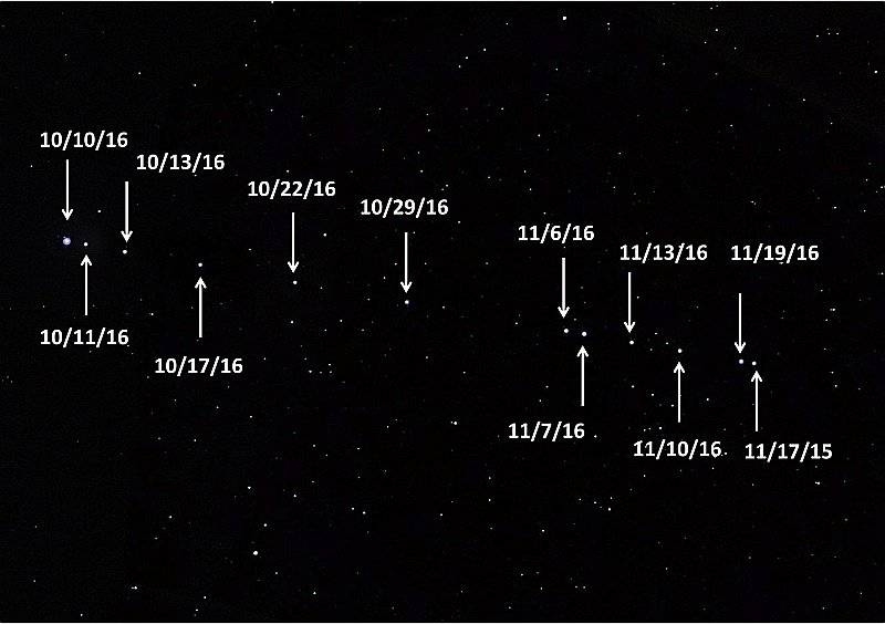

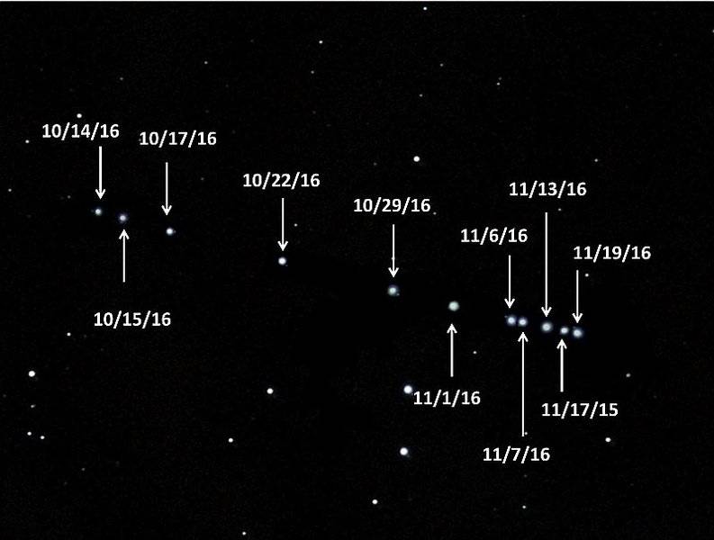

Clear skies are gone for the winter, here's as much as I was able to get. Next summer I may have a chance at Pluto. First one is Uranus, next one is Neptune- they look a little different because I scaled them differently to fit. Enjoy!
Star field composite with arrows marking a faint moving object on dates from 10/10/16 to 11/17/15, shifting position across the frame over the weeks.
Night sky photo of a star field with arrows marking the slowly moving path of Neptune, each labelled with a date from 10/14/16 to 11/19/16; a few arrows note dates in 2015 and 2016.

Pluto is actually visible with the sort of telescopes used by enthusiastic amateurs?
Possibly- but that's the point of trying, right? Pluto's apparent magnitude varies between 13.6 and 16.3, I can reliably detect magnitude 15 objects with a 5.5" refractor.
