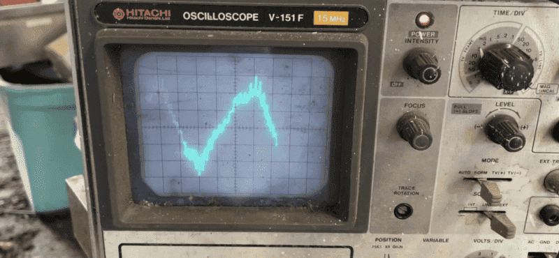

AmericaN8 said:
The wave form is shaped a lot like a chainsaw link. um, it spikes high then trails off then drops to the opposite, spikes, trails etc.
How did you measure the wavedform? Did you use a battery powered oscilloscope or similar?

I used a regular 110 o-scope but it was plugged into city power with perfect sine wave at 60.00hz.
It could have been a coincidence but i did this odd job for a temp agency years ago where we were repairing cracks in cement. The company got a new portable generator and new dewalt grinders. Two or three grinders burned up after just a few days. Then they got a nice inverter generator and no more grinders burned up. I don't really know the cause for sure, it could be a combination of being underpowered and the cement dust. but i do know that those arent concidered sensative electronics. Pretty sure they were brushed on/of switch controlled.

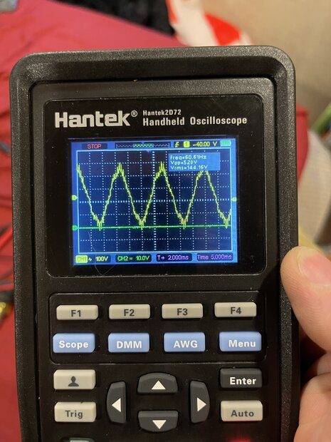

Just a little update for the heck of it, using a handheld o-scope the wave form is still pretty dirty. Looks more like a sawtooth than it does a sine wave.
