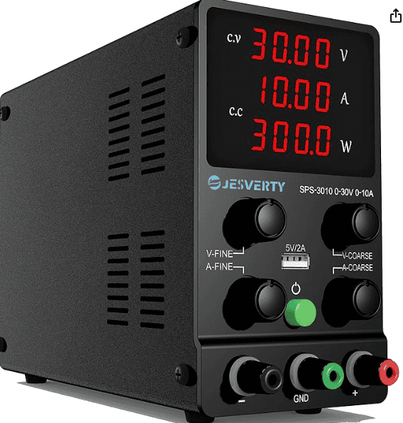

I'm thinking of buying a voltage source to charge batteries instead of a dedicated charger.

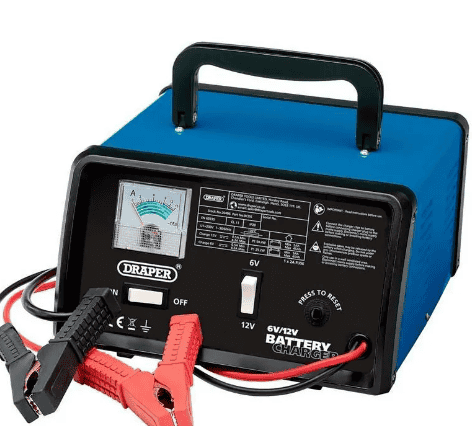

I want to buy a car/motorcycle battery charger because it's a very convenient thing to have.
Also, for a while, I have wanted to have a simple power source like shown.
How safe is it to use it to charge lead-acid batteries from cars or motorcycles? I know the simplest option is to buy the specific product for that task but a power supply seems so much more versatile as long as I dial in the right limits for the voltage and current in the power source.

Yes, you can use an adjustable power supply to charge batteries. You need to study up on the proper voltages and currents. I have done it successfully.
Battery chargers are normally protected against accidental reverse connections, while power supplies will be damaged. I have also had a failure: https://www.physicsforums.com/threads/fried-my-power-supply-by-doing-a-bad-thing.1049093/. I recommend that you learn from my experience and use the proper tool for the job.

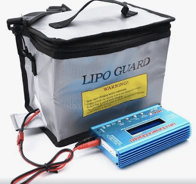

  2. I will get one of those safety bags for the charging process. I have seen them typically used for LiPo batteries. Do you think they will be OK for lead batteries too?
Not really. When a lead-acid battery goes off it means hot acid spraying everywhere: when a Li-Po battery explodes, it's a completely different story, requiring different kind of protection.
Regarding the original question: in any regular circumstances, using the power supply can be made to be fine.
However: you don't even have the thing yet, but you are already tasting the bother what makes the difference between using the charger meant to be used in the garage, on a battery mounted in the car and using the power supply, meant to be used on a lab bench.
Won't avoiding all that hustle worth the money of having a dedicated charger?

It's clear to me that you are not really critically thinking this. Any gassing done by the battery will be trapped in the bag. Hydrogen gas. Doesn't matter what kind of charger you have if you are trapping hydrogen in a container that also has connections with a good potential for arcing.
