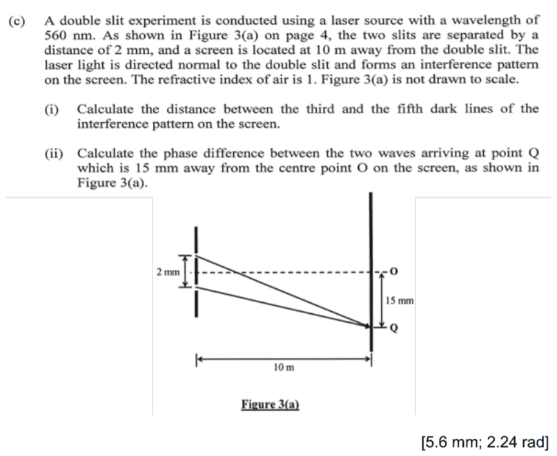

(c) A double slit experiment is conducted using a laser source with a wavelength of 560 nm. As shown in Figure 3(a) on page 4, the two slits are separated by a distance of 2 mm, and a screen is located at 10 m away from the double slit. The laser light is directed normal to the double slit and forms an interference pattern on the screen. The refractive index of air is 1. Figure 3(a) is not drawn to scale.
(i) Calculate the distance between the third and the fifth dark lines of the interference pattern on the screen.
(ii) Calculate the phase difference between the two waves arriving at point Q which is 15 mm away from the centre point 0 on the screen, as shown in Figure 3(a).
(only ii is needed)
$$Δφ = 2π \frac{L_2 - L_1}{λ}$$
$$Δφ = 2π \frac{\sqrt{0.016^2+10^2}-\sqrt{0.014^2+10^2}}{560*10^{-9}}$$
$$Δφ = 33.659 rad$$Answer = 2.24 rad (unsure if the answer provided is correct/wrong)
I didn't see your calculation, but, you know ... $$33.659 = 2.24 + 5*2\pi$$

Using top slit, the distance travelled, L1 can be found using pythagoras theorem. Number of wavelength can be found by taking the total L1 length and dividing by the wavelength of the laser source. Then to know the phase, just multiply by 2π.
Likewise, I did the same thing for the bottom slit. Then i subtract them.
However, I get the same thing though. I think I could be missing something out, or my understanding could be wrong. Need to figure out which.
The point about the laser is that laser light is coherent - all the light is in step or in phase. So, the phase of the light arriving at the top slit is the same as the phase of the light arriving at the bottom slit. Hence, the phase of the light leaving the top slit and the phase of the light leaving the bottom slit are both the same.
Both beams start their journeys to Q at the same phase - for simplicity, assume it is zero.
Your method is correct.
Calculate the difference in the path lengths and express it in wavelengths - it will be a number like 5.36 wavelengths. So, the upper slit light travels 5.36 wavelengths further than the lower slit light so it is 0.36 wavelengths "out of step" or the phase difference is 0.36 wavelengths. As one wavelength is equal to 2 pi you have the phase difference.
