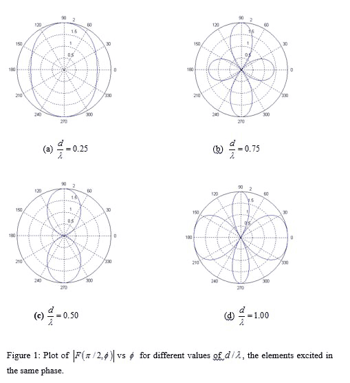

If you are exctly on the axis, and the two sources in phase, then the oscillations going past are essentially the same as a doubled strength source for all distances to the sources (slits). The max/min pattern off-axis scales with distance (the angle remains constant).
To make it clear, the amplitudes will add, giving twice amplitude, which corresponds to four times the radiated power in that direction.
At the same time, and to keep to the conservation law of Energy, the resultant in other directions will be less than that. A maximum along the axis can result in many different patterns, depending on the spacing. If the two sources are λ/2 apart then there will be no radiation along the axis. The diagram below shows what happens with (omnidirectional) radiating elements with different spacing. In this case, all 360 degrees of azimuth are shown but you will get my point; the integral is always twice the power but maxima can be greater than that. A bit off topic, maybe but it helps avoid drawing wrong conclusions about the Energy carried by Waves.
