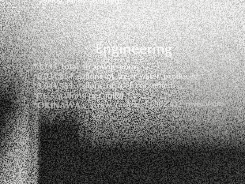

I was on a old LPH class ship for 2+ years with a crew of 600 sailors and 2000 marines. The LHA/LHD/LPH carry aircraft but their mission is distant from what a typical aircraft carrier would be. Close in ground support of infantry was their job on my old ship and I'm pretty sure not much has changed.
This is us in 1980 at port in Singapore months before the Iran mission in the gulf.
We had old school oil fired steam engines.
Maybe an SMR is a good idea for this class of ship.
