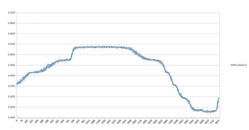

This is last nights chart (from about 10PM to sunrise) into about a 3K load from about 500W total of panels. The hump at about 800 samples is where a separate panel of 120W started getting light from the moon. Maybe 20uW at max power. :biggrin:
The DAQ is a Linux based NI-DAQCard-700 12-bit diff-input card using my kernel driver with a 128X oversample to squeeze a few extra bits of resolution.

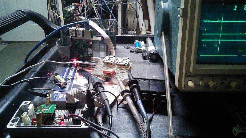

Setting up a new rig for the Super Blood moon this month. I'll use a RPi2 this time for the data logger with another custom Linux kernel driver for the ADS1220 24bit ADC chip via the SPI port.
Just finished up the hardware and software calibration with a old Omega CL511 calibrator.
A few pics of the test setup and build.
The home workshop is a bit of a mess but it's all working now.:smile:

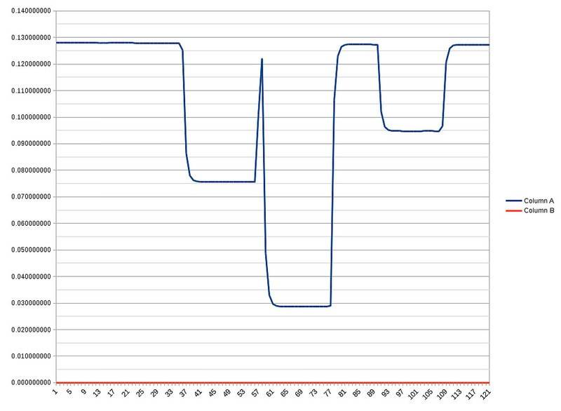

Using a 4.998k load resistor for the solar panel and the calibration voltage adjustments @ 2000mV from the standard. The application program 'moonlight' logs the data to a text file with a time-stamp and sequential numbers for each reading so the data can be processed later.

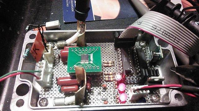

ADC front-end board powered by two 9 volt batteries for a bipolar analog supply.
The brass plates are ground plane/shields for the input filter and are connected to the metal box for (some) electrostatic shielding.
From the program info header:
* A special version for the TI ADS1220 SD ADC converter chip (and MCP3911 later) for low voltage sensing and
* solar panel panel light detection. +- 2.048, 1.024 and 0.512 voltage ranges @ 20 bits of usable resolution
* ADC is in single-shot conversion mode @20SPS, PGA disabled and gain from 1, 2 and 4 in differential
* signal detection mode, 50/60Hz rejection enabled. 500kHz SPI clock with direct RPi2 connection
* Analog +- 2.5VDC from Zener regulators for the bipolar input stage with external 2.5VDC Zener input
* signal protection.

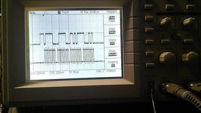

RPi2 with SPI connection to ADC with a breakout board to scope the signals while writing the driver.
SPI data stream (clocks on the bottom trace) to the RPi2 in 24 bit format after a read command. It's a Delta-Sigma converter so the last few bits are just noise but 20bits are usable.
This should be in the micro-watt range during the full moon with a 5k load resistor.

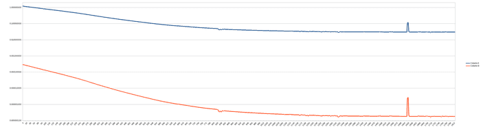

Running some baseline charts with the Raspberry Pi DAQ system. This is a sunset to night sky (with some cloud cover) with about a 20% moon in the sky. The first little glitch is me moving the panels (3 80W panels isolated from the rest of the panels) to line up with the moons position in the sky, the second large spike is from a cars headlights driving out of the cul-de-sac I live in.
Y Log scale for Volts in BLUE and Watts in RED, X sample number.

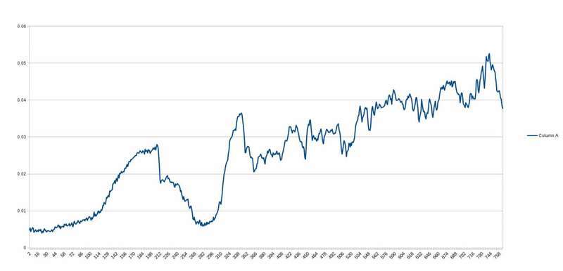

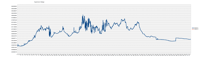

Here is the chart from most of last night as the moon moves into range and sets. It's starting to look like the weather might not be good on the Blood-moon night near Portland as the chart shows the light variations from cloud cover and ice crystals high in the sky.
Those sharp isolated spikes in the first part of the chart were driving me crazy as I thought there was a defect somewhere causing them but I matched the times to airplanes flying near the house (I'm in the glide-path for PDX) after seeing the spikes stopped after about midnight.

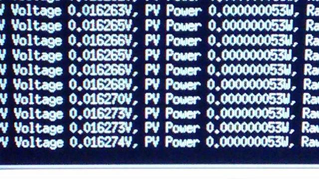

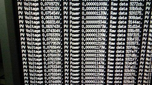

1.2 uW (1.34uW at the last reading) power from a 240W array, I could charge a capacitor and use it to run my cell phone.

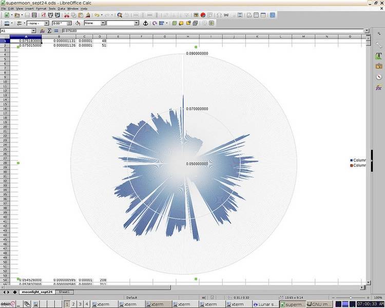

A different type of chart from last nights Voltage data:
Lots of clouds.
The 'X' time data moves counter-clockwise.

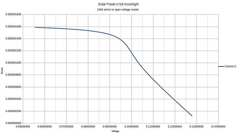

Measured voltage under full moon light (not from supermoon data) with open circuit, 4.7k, 1.0k and 10.0k resistors vs voltage.
A simple model of the panel characteristics during moonlight at varying power levels using the resistor/voltage data.
You can see a somewhat typical Solar PN curve even at low-light levels.

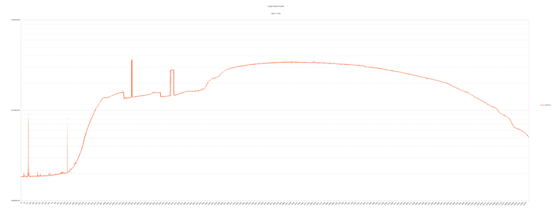

This is the log power chart from the Super Blood moon Sept 27 2015.
All eclipse voltage, power, current data and graphs are with the 4.7K load resistor.
It starts at almost full 'Blood' stage (the tall sharp spikes are car lights) and moves to left -> right to full moonlight.
The first ramp is the main panel array in moonlight (the small ramps are me moving the array to center sky and the longer spike is an open circuit voltage reading taken by removing the 4.7K load for a while for model data)
The second ramp is when the other panel array starts getting full moonlight and both arrays are in view of the full moon until early morning when the program is stopped before dawn.
Big image:
