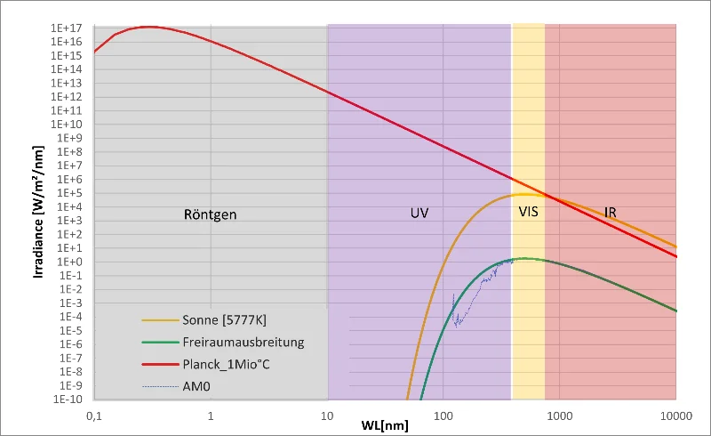

Matthias_Rost
TL;DR
When you calculate a plasma with 1.000.000 K then you get according to planck's formula a plasma, which emits x-Ray / Gamma-Radiation in a quite deadly intensity. Can somebody explain all this ultra-high temperatures posted in all the fusion experiments?
Plotted is the Irradiance over Wavelength.
Please check for logarithmic scaling.
As you can see, there are 4 curves.
Blue AM 0 as measured
yellow Planck for 5777 K
green Planck for, 5777 K after free space expansion
red Planck for 1.000.000 K
To me the idea of a gamma-Ray-source on earth, below the magnetic field, which protects life on earth from solar radiation, in an intensity, which is way way way outer hand, makes no sense to me. If they really get these high temperatures realized in fusion reactors, we would, according to Planck, already been dead.
The absolute values of irradiance on your graph is applicable only to a enough large volume of plasma which absorb as a Black Body. Small volume would be transparent and have much much less emissivity.
The Volume V doesn't matter at all. If you use a tungsten oxide wire and heat it up to 5777 K it will emit almost the same spectrum as the sun. Difference will only be the absorption bands of WO_3 and H/He. And the different prefactors for ε and A. And it's also not about transparency. Transparency would matter if you used a lamp to shine through a plasma. But this plasma is the lamp. Therefore, everything that matters is the surface between the plasma and the vacuum. I = ε*A*σ*T^4. also accounts for gray bodies, when ε<1.
You apparently didn't get Planck's law. For instance, what is ε?. ε(λ) =1-R(λ). So yeah, if the Reflectivity at the interface is greater than zero for the concerning Wavelength, then it's a gray body. Which for perpendicular emission can be written by Fresnel: R =[(n_1-n_2)/(n_1+n_2)]². Vacuum has an n of 1 and most gases have n around 1. And a plasma can sometimes have a higher n, but these plasmas in the reactors mostly have a low pressure, that's why they are not optically dense and that's why n is also small. Example: water --> air. R =[(1,5-1)/(1,5+1)]² =0,04. So (1-R) would be ε = 0,96.
Let's have a look at the blue and green curve. As you can see, there is almost no deviation between Planck using ε = 1,00 and the AM0 Spectrum. Plus, the sun is an optical dense plasma due to its high gravitation. So I would say ε ~ 1,00. The differences between blue and green curve don't originate from Emissivity/Reflectivity issues. These are the absorption bands of He, H, D and T.

Matthias_Rost said:
..You apparently didn't get Planck's law..
What do you think the emissivity coefficient would be if the mean free path of photons (e.g., gamma photons) is much greater than the size of the volume? The emissivity would be about zero. For a black body, the mean free path of photons needs to be much smaller than the volume size, as in the case of a tungsten wire.
Yes, but the amount of energy radiated by the wire will be much lower than the sun. The amount of energy you need to absorb to protect you from the amount of UV radiation emitted from a tungsten oxide wire is considerably less than required to block UV from the sun.

It’s not the volume itself that matters, but the relationship between the volume size and the photon’s mean free path. That’s what I’m referring to. If radiation passes through a small volume with low absorption, the emissivity of that volume will be proportionally low.
Yeah, but that's internal wave propagation. Planck's on the contrary has nothing to do with internal wave propagation in a bulk medium. Planck's law only accounts for the emission of radiation from one object to another or in into free space.
Absorption can be calculated via Lambert-Beer:
Which is I/I_0=exp(-a*c*d).
Whereas I, is the intensity, I_0 is the starting intensity, a is the absorption coefficient, c is the concentration of the absorbance and d is the thickness of the material.
And btw. when light is absorbed, then the Energy conservation holds. Therefore, when a photon is absorbed, E_phot=h*v adds up to E_therm = 3/2*k_b*T. Therefore, the internal light Absorption has no consequence on Planck's law and therefore also not for Stefan-Boltzmann-Law. Since they only depend on Temperature T, Surface Area of the Object A_s, Stefan-Boltzmann-constant σ and the emissivity ε(λ) (= 1-R(λ) with R the reflectivity for surfaces, of course for internal propagation ε(λ) = 1-A(λ), with A the Absorption part, but that's a no-brainer)
I=ε*σ*A_s*T^4. See, the Irradiance does not depend on the Absorption or density of the medium at all, since it's the emission out of the body, which has nothing to do with internal wave propagation.
And we are far far far away from effects like the Casimir-Effect, where the mean free path length as a certain effect. But which holds only true, when the distance light has to overcome is smaller than the size of the wavelength. Then your right, then such effects can happen, so on a nanoscale then yes there some effects that might happen, but not for Objects in the range of thicknesses of some microns and above.
And yeah ε(λ)=α(λ) will still hold true even in that case. But that was never the point. You see.
For instance, if you look at the plot, than you can see a deviation from the blue to the green curve for small wavelength. Which is due to He, and H-absorption bands. But nevertheless, the Rest of the curve still holds true. So yep, I also accounted for absorption effects inside the volume. The point is, as you can see the sun can also have a higher emission than Planck, since when hydrogen absorbs energy it also has to be deposited somewhere, which will then either be at lower energies fulfilling Planck or at higher energies, due to some specific emission energy band, which is also in the plot. Point is, energy conservation holds true. And that is the main point I stress out. Temperatures of 1 Mio °C or above for manmade plasmas are physical nonsense, since they violate energy conservation and Planck's law. Because if they really ever had built any Plasma with 1 Mio °C in Temperature, we would all be dead yet. Plus, such a small Torus would emit more radiation than the whole sun per second. Now get it? It's bull. But as long as you can read it in the newspapers or on your smartphone, nobody ever will question it.
Planck’s radiation law applies to an ideal Black Body, where electromagnetic waves are absorbed and re-emitted multiple times within the material. This requires that the mean free path of the radiation is much shorter than the size of the volume, ensuring thermal equilibrium. If this condition is not satisfied, Planck’s law does not accurately describe the system.
Similarly, the Beer–Lambert law is valid only for media with low absorption. In highly absorbing materials, the assumptions behind the law break down, and it no longer provides reliable results.
Wrong Planck only applies to black bodies, when epsilon = 1, then its a black body, otherwise it|s a grey body. So you then have to check for epsilon(lambda). This doesnt mean that physics is not applicable anymore. Since Planck can be directly derived from the 2nd law of thermodynamics. So as soon as you state, that Planck is not applicable for bodies with a) a high temperature, b) a high& low pressure, c) different color, d) thermodynamic gradients inside the material, you are wrong.
You dont need any multiple reabsorbtion to be inside thermodynamic equilibrium, so that Planck holds true. For instance. Take thin Glassrod, or even a thinner glassfiber. Standard Soda-Lime-Glass has a quite remarkable low thermal conductivity and a quite good transparency over a broad wavelength range. And you can colour it from the outside as you like and if you put some colouring elements like Fe, Cr, Ni, Ti inside the glassmelt, when recycling soda-lime-glass shards, you can also do this on the inside volume. And now you can do a trick. You take an IR-Camera and view the Glassrod from the Top, so zou only see the temperature variation in the cross section of the glassrod, at the edge where it was cut. And since the thermal conductivity is quite low you can also put the glassrod inside an oven, preferrably an inductively coupled oven with a platinum crucible and heat the crucible up. Then you will see, that the glassrod is definitvely not in thermal equilibrium, since it is cold inside and hot on the outside. And as long as you dont heat up over 400 degrees celsius the glassrod wont melt. What do we learn about that? Well we can now use a spectrometer and measure the emitted spectrum. And guess what if paint the surface black, for instance with vanta black, works quite well or you also just a black Edding, which has almost constant reflectivity of 2%. Then you get a measurement curve and what comes out? Ah Plancks law. And yep it is then not consistent to the average Volume Temperature of the Object, since it|s not in thermal equilibrium. But guess what, its consistent to the surface Temperature.
And please I dont get it, why you dont get Plancks law. Its easy peasy to do. And again it doesnt matter, what the Volume does. Its a solely for surfaces of objects valid law. What do you think how every accredited calibration institute calibrates IR-Cameras or stuff like solar cells. They use a standard black body to calibrate for emission of objects. What does that look like? Its nothing more than a shoe carton painted on the inside with black color. And then the shoe carton is heated up. So what you measures is the temperature of the shoe carton and the emission of radiation through a circular hole inside the box. And what you get then, ahh Plancks law. I reallz dont get, whz zou do theoreticalliriye Plancks law. It ist fundamental and directly derived by 2nd law of thermodynamics. And please do me a favour and try to measure (in praxis) the spectrum of any body with known emissivity (= 1-Reflectivity) under conditions which violate thermal equilibrium. And then if you plot the data over the actual surface temperature, that Planck still holds. And this is not remarkable, this is just the consequence, that any surface is in thermal equilibrium at any time you like, just the volume is not.
