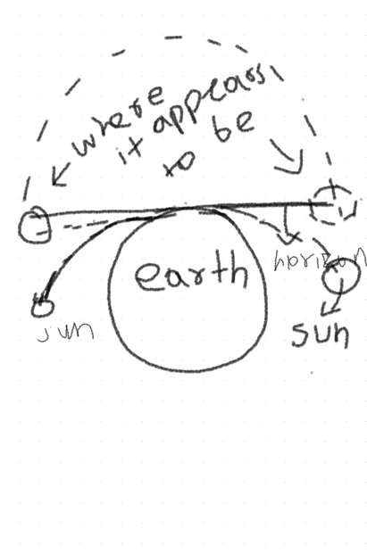

For simplicity, consider yourself on the equator.
At sunrise, can you see the upper edge of the sun before it is geometrically lined up with the horizon and you?
At sunset, the upper edge of the sun is what was the lower edge of the sun at sunrise,
At sunset, can you see the upper edge of the sun after it is geometrically lined up with the horizon and you?

Your diagram seems to show the sun going around clockwise relative to the Earth, so I guess we are looking down on the N pole, with W on the right and E on the left.
The upper image of the sun on the right shows where you would see it set if no refraction, and the lower right where it is when you do see it set. Which is later?

Yes I can stil see the upper edge after it is geometrically lined up with the horizon. So like the day starts earlier and ends later for us observers? Hence the time interval is longer?
Yes, spot-on.

@tellmesomething, just noticed an issue with what you wrote (sorry - I should have read it more carefully).
That's only true at sunset.
At sunrise, you can see the upper edge before it is geometrically lined up with the horizon.
Yes.

In your diagram the sun is going clockwise, so it is descending on the right. In which position is it later, upper right or lower right?

The sun is physically on the lower right but we see it on the upper right right during sunset...its virtual image is what we see and in our pov it stays for longer..
Right.
