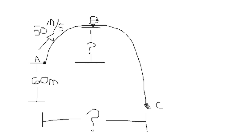

Can someone draw this diagram for me because I must be getting the wrong picture

Determine the maximum horizontal distance that a projectile will have at a height of 60 m above its origin if it is fired at an angle at 70degrees from the horizontal with a velocity of 50m/s
here is my diagram.
How about this:
gneill's diagram is the correct one.
Note that there are 2 horizontal distances such that the height of the projectile is at 60m.
