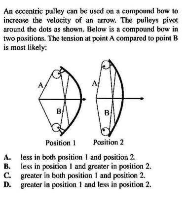

Can someone explain this please?? Weird pulley with Tension
See attached picture for problem
n/a
The answer is B. No idea why.
Any help would be appreciated. Thanks!

Have you tried drawing a FBD for the pulley's in each position?
Notice that the pulleys are not pivoted at their centers.
You need to be careful about where the forces get drawn.
