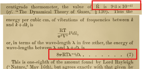

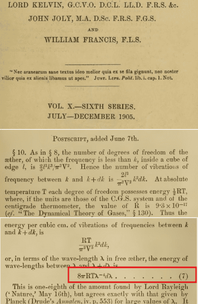

Actually, the exact formulation of (1.1) - or a close relative of it (*) - first appeared in J.H Jeans' “On the partition of Energy between Matter and Aether” ,issue 55 of The London Edinburg and Dublin Philosophical Magazine and Journal of Science, in the July 1905 [see (7) of the Figure 1].

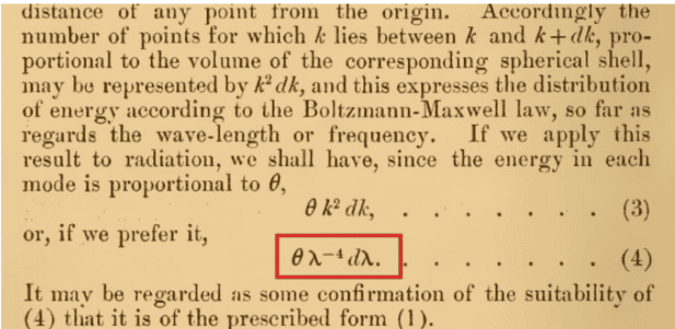

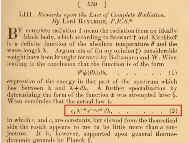

It is true that Lord Rayleigh stated that blackbody radiation is proportional to ##1/\lambda^4## in the article entitled “Remarks upon the Law of Complete Radiation,” The London, Edinburgh, and Dublin Philosophical Magazine And Journal Of Science,” Vol. 50, Fifth Series July-December 1900 (see Figure 3), so before the Planck formula of December 1900, but the official formulation as we know it today by Rayleigh-Jeans was not officially published until 5 years later.

There is small a discrepancy between (1.1) and its original formulation (7) in in FIGURE 1 (highlighted in FIGURE 4 below)
Actually in the above-mentioned 1905 article, James Jeans written the formula
$$u(\lambda, T) = \frac{8 \pi R T}{\lambda^4}\tag{1.3}$$
through a constant ##R## of the value of ##9,3 \times 10^{-17}## ##erg/K##
FIGURE 4

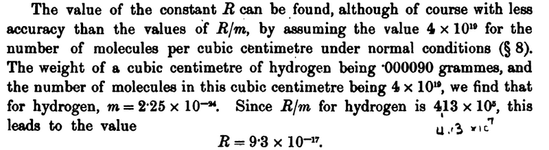

I make the assumption that the constant R in (1.3) was an empirical constant derived from Rayleigh, which Jeans mentions for the 1st time in his "The Dynamical Theory of Gases, 1st edition, Cambridge at the University Press 1904", FIGURE 5
Probably the empirical experimental constant derived by Rayleigh was later replaced by more precise experimental data which lead to (1.1).
I honestly could not reconstruct where the (1.1) was first originally formulated
:oldconfused:
If anyone would like to help me to fill this gap I would be grateful.
FIGURE 5
