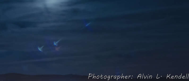

can someone look at them two photos i have linked on photobucket and tell me what it is that I am seeing.

It appears that you are seeing some really bad internal reflections/lens flare. Nothing special.
its not lens flare or anything to do with the lens. i can garentee you that.. i took about 40 photos that night.. and only two came out with that weird stuff showing up... and I've done research and i found out its caused by some sort atmospheric condition. I am trying to find the name of it.

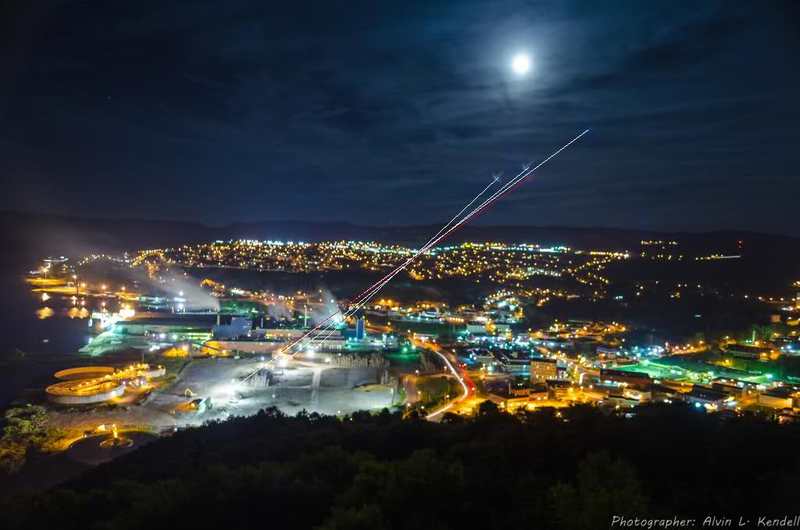

It's obviously some sort of reflection, in that the three brightest lights in the lower left of the picture are opposite those white marks on the upper right, and a slightly less bright light with an orange tinge matches the more orange-coloured mark below the middle white one on the right. If you rotate the picture by a half turn (or flip it vertically then horizontally) those marks match the locations of the lights.
Jonathan clearly called it. NB how lines connecting the lights and the flares cross right in the centre:

It is internal reflection your lens and some asymmetric flare. There is nothing in "atmospheric conditions" that can produce those arrow-head artifacts.

It also reminds me of high speed re-entry shock waves. Did anyone see it form? For the guys that think that the things line up with the lights on the ground,,, A big NO there. I not only study physics and psychology; I am also an artist and have a very finely tuned eye for perspective (among otherthings) and these things do not line up even close on the ground. If you enlarge a picture the errors are magnified in any kind picture. If I can see that the lines are just slightly out of allignment at the scale seen on your monitor and you enlarge it the lines will become more and more out of line and loose perspective more and more as the image gets bigger. If you add to that that a picture looses definition with enlargment hopefully you will realize that the light lining up theory does not work. Also the lines postulated here do not line up with center or core of the objects.

In this case, it's just within the camera. The shapes are known as "caustics" and are typical for reflections or refraction of light in a curved surface, for example sunlight reflected within a coffee cup.
There are some atmospheric conditions which can cause some interesting effects in the sky, especially "sun dogs" and "moon dogs", which are caused by ice crystals. Google those for more information. However, this particular case is clearly an internal reflection rather than anything atmospheric.
definitely internal reflection or lens flare - Pick up a lens and switch on a bright light. Then slowly wave the lens around over a sheet of white paper with the lamp shining downwards. You can reproduce those same shapes and see them projected onto the paper.

Its been made painfully clear how these are internal lens reflections. And, when you're using a modern lens, which typically have several lenses within them, it is very possible to have two lens flares of different intensity, very close together.
