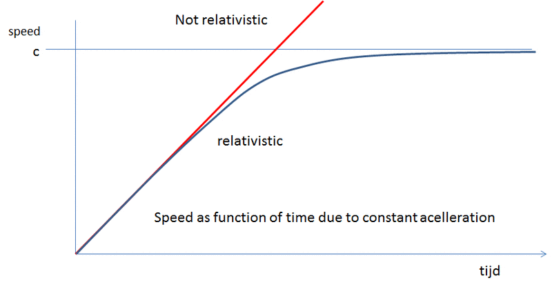

we know that in our universe nothing can go faster than c. accordng to Einstein curvature related to a dense object such as black hole can become so large that according to the waterfall model we get an event horizon because that is the border where the fallling waterfall exceeds the speed of light. how do we know that this is correct and not limited to c also?

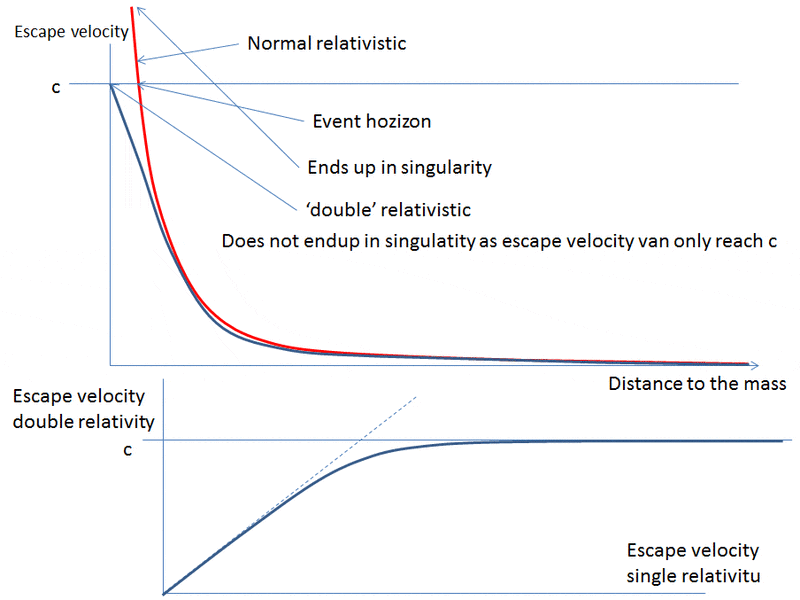

I assume we cannot define experiments that can confirm this because we can never create the circumstances on earth. So could it be possible that actually this is not what happens but instead curvature of spacetime is limited due to the fact that there cannot be any effect having a speed larger than the speed of causality?
The result would be dramatically different from our theory so far as it would mean that we don't have event horizons and also no singulatities because then only this maximum of c can be reached at the limit reaching the mass that causes the curvature.
So my question is if there is evidence for this part of general relativity preventing it from being different from as we think it is? (such as contradictions proving that this alternative cannot be the case?) so can be prove that the 'double relativity' efect in the second picture cannot be the case?

first picture shows the effect of relativity causing the speed due to constant acelleration not to exceed c
second picture shows the idea of a second relativistic effect causing the general relativity to be limited by a second higher level relativity (I call that 'double relativity') that limits the curvature of spacetime to a maximum similar to limiting the speed to c at relativity compared to infinite at
traditional theory

'tijd' = 'time' in the first picture (sorry it was tanslated from Dutch)

second picture
Is your personal speculation, which is off limits here. You have received a number of good responses that describe what relativity says.
