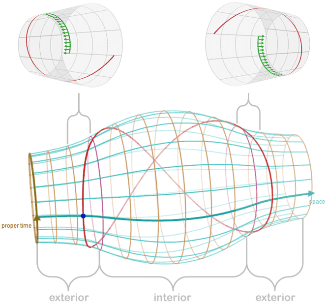

ESponge2000 said:
But somehow these 2 upward accelerations do not result in Botswana and Honolulu moving away from each other nor earth inflating like a balloon. Is that because curvature of spacetime leads to closed loops or explain that ?
No closed loops are needed, this is simply a feature of curvature even without loops.
Consider the simplest curved surface, a sphere. While it does have loops, we are only going to look at a small section. Suppose that you have two people that are both walking, one a little north of the equator and one a little south of the equator. If they both start by going due east and walk in a straight line, their paths will gradually get closer. Instead, if they want to keep the same distance they will need to follow their respective latitude lines rather than a straight line. Latitude lines are curved, so to do that they will need to continually turn with their latitude line. The one to the north will need to turn left and the one to the south will need to turn right. So, to keep the distance constant between them, on a curved surface, requires that they continually turn in opposite directions.
In spacetime, proper acceleration is how much an object's path turns. So two objects on opposite sides of the earth must accelerate in opposite directions in order to keep their distance constant. Just as two paths on opposite sides of the equator must turn in opposite directions to keep their distance constant.
This is where the intrinsic curvature of space-time comes in.
First, try to understand how gravity works in GR locally, which is visualized in the animation below. Note that the conical-space-time in the animation below doesn't have intrinsic curvature, because you can unroll a cone mantle onto a flat plane without distortion.
As you see, the apple hanging on the branch must continuously turn away from the locally straight (geodesic) path in space-time, just to stay at constant height. That turn away from the geodesic path is what an accelerometer measures as upwards proper acceleration.
Then, when you zoom out to see both sides of the planet, the space-time geometry looks like in the image below. As you see, the local cone is just an approximation of a thin slice, of that geometry. And on the other side the cone point the other way.
To keep constant distance, and avoid drifting towards each other by moving locally straight ahead in space-time (on geodesics), objects on opposite sides of the Earth must continuously turn in space-time in opposite directions, away from geodesic paths (red line), and thus experience proper acceleration in opposite directions.

@ESponge2000 note that the loops in the @A.T. digrams are just for convenience in graphing. The loops do not represent closed timelike curves in spacetime
@ESponge2000 Yes, imagine the diagram is multi layered, like a roll of foil. So after each round around that bulged cylinder you arrive on a new layer.
The red path is a geodesic for an object falling through the planet without resistance. Like a non-spinning planet without atmosphere, and a tunnel trough the center to the other side.
