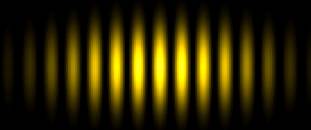

No, in the Young experiment the intensity of the interference pattern varies about sinusoidally with the distance from the centre. See
http://www.a-levelphysicstutor.com/images/waves/youngs-frings-screen.jpg
In case of two monocromatic sources of the same wavelength it would be a sine function.
ehild said:
The change of wavelength makes the interference peaks to have some width.
True! This is what I just pointed out and opened PF to discuss you about this.
As their not just constructive and destructive interference(not just maxima and minima) their could be intermediate intensities for even a particular unique wavelength.

Geometry of the Young's Slits experiment is not enough to reveal the effect of a small amount of spread in the wavelength of the light source. (No numbers here, I realize)
You can get the first few fringes even when you use the light from a very crude coloured filter (i.e. wide bandwidth). Young's experiments do not actually produce any significant disagreement with the earlier statement. The depth of the minima can be limited by failure to get really good destructive interference. The position of the minima is determined by the mean frequency.

The finite bandwidth causes that the intensity distribution of the interference pattern is not quite sinusoidal, but dos not alter the position of the maxima.
Also I do not understand this.
Effect of small amount of spread in wavelength(the above two questions are about the cause of this spread) while here in this paragraph I am more concerned to ask you how the spreading in wavelength is providing sustained interference.
Say if I have a bandwidth of wavelength not just unique wavelength(that is wavelength is some how spread) how will then I have position of maxima and minima unique because position of maxima and minima will no more be unique as each of the wavelength is ready to form it's maxima(and minima too) in some position other then the other wavelength so no maxima and talking about position of maxima and minima in such a band of wavelength should have no meaning.
I think the change of wavelength(if it changes with time) rather rather changes the position of maximas (nλD/d) and minimas should change and Young should not have sustained interference.
And if instead the wavelength change means their is a band of wavelengths then I think as you said we have peaks to have a band. Not sure if the abrupt phase jump not causing change in wavelength with time and why not giving unjustified interference when it was said phase jump is sure to affect monoctomocity of source.
