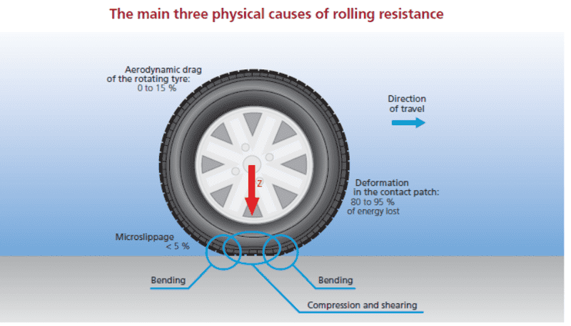

I was wondering that if rolling resistance is basically caused by slight deformation of a body, we must have formulas in place to relate it to the physical and material properties of a body. But when I went ravaging for it in library or internet, everything was experimental. I wished to know from all fellow PFians if you have knowledge of any formula which can calculate the rolling resistance coefficient of a body from elasticity,radius,density, etc. without any experimentation whatsoever ?

I understood the question, but your terminology may have a problem. There is no such thing as rolling friction (except for bearing friction maybe). Do you mean that you want to understand if Rolling Resistance can be calculated?
http://www.josephjohansson.com/wp-content/uploads/2016/03/Physical-Causes.png
