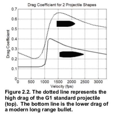

For what its worth and as I understand it from [1], the BC for a particular bullet varies as a function of speed since the drag coefficient varies with speed with a profile that is somewhat dependent on the shape, as shown below (also from [1]).
I also understand that the BC profile for most long range ammunition match well with a scaled G7 bullet (bottom curve) rather than the G1 (upper curve) and if that is also the case for your bullet you may be able to establish a BC speed profile from that. However, I am not aware of the exact data set for the G7 drag profile and [1] is also written using imperial units making it difficult to compare with your data. If you "just" need the BC data I would suggest that you use a ballistic calculator that is able to base its calculations on the proper bullet shape or (constant) form factor relative to a standard bullet (like G7). If you need theoretical insight I suggest you read [1] or similar.
[1] Applied Ballistics For Long-Range Shooting 2nd Edition, Bryan Litz, 2011.
