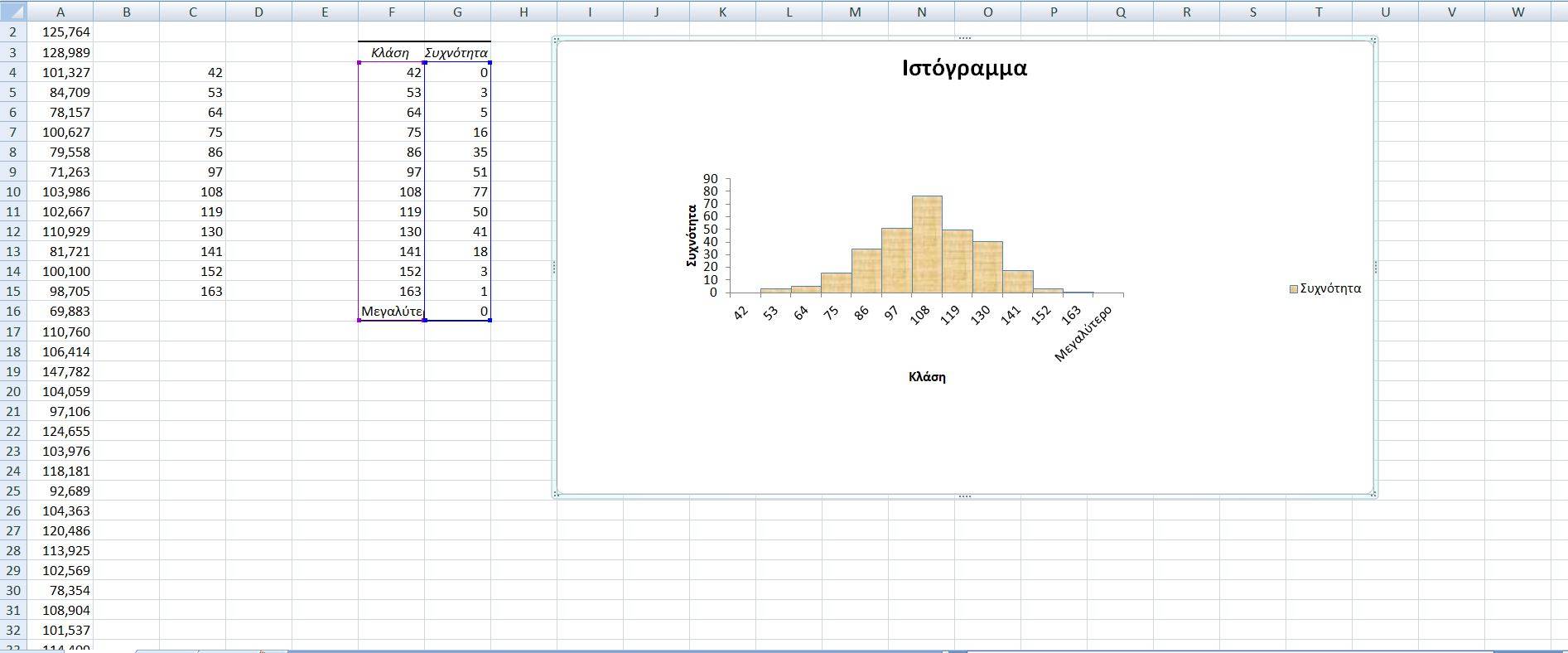

I got the following:
That means that the distribution is symmetric, or not? (Wondering)
Yep. All correct. (Nod)

Take a look at your previous histogram. Doesn't it have a table on the left? A table with columns titled Class and Frequency? (Wondering)
That is the frequency distribution table. (Emo)
Ahh so we get this table also automatically from Excel.

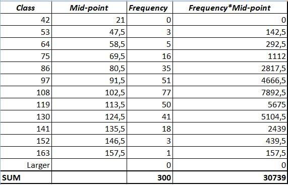

I got it!
At the next question we have to estimate the the mean value and the median from the data of frequency distribution.
We get the following, don't we?
The first mid-point is $(0+42)/2=21$, or not? And we cannot calculate the median of the class Larger, can we?
Therefore the mean value is $\frac{30739}{300}=102.463$. At the beginning of the exercise I calculated the mean value of the square meters to be $102.307$. So the estimated mean value $102.463$ is closed to it, right? (Wondering) For the estimated median do we use the formula $$\text{lower boundary of group of median}+\frac{\frac{\text{total number of values}}{2}-\text{sum of frequencies before median}}{\text{frequency of the median group}}\cdot \text{group width}$$ ? (Wondering)

I got it!
We have a fixed bin size of 11, don't we?
Shouldn't we pick the first mid-point then at $42 - \frac{11}2 = 36.5$ for consistency? (Wondering)
It doesn't really matter though, since the corresponding frequency is 0. So it doesn't contribute to the calculation of the median. Good.
We might calculate its midpoint by using the fixed bin size of 11 again.
There is no need though, as this bin should be empty. And it is. (Whew)
mathmari said:
Therefore the mean value is $\frac{30739}{300}=102.463$. At the beginning of the exercise I calculated the mean value of the square meters to be $102.307$. So the estimated mean value $102.463$ is close to it, right?
Yep. (Nod)
