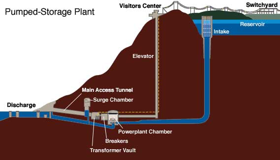

This question has suddenly become more important when electric companies started using windmills. Wind is seldom constant, so if the windmills produce AC, the frequency will vary with the speed of the windmill and cannot therefore be added directly into the power grid which has a fixed frequency. One solution is to convert to DC and use the DC to create AC with the correct frequency and phase. My take on it was to use the power from the windmills in conjunction with a hydroelectric plant - use the windmill power to pump some of the water from the downside of the hydroelectric plant up to the input dam - to be used again. In this case we are storing the inconvenient AC from the windmills as potential energy in the water.

Exactly. And http://www.hydro.org/tech-and-policy/technology/pumped-storage/ is a good way.
Pumped storage is an essential solution for grid reliability, providing one of the few large-scale, affordable means of storing and deploying electricity.
It is certainly one way - whether it is a "good" way depends on the circumstances... which are not present in the original question, which has been answered.
