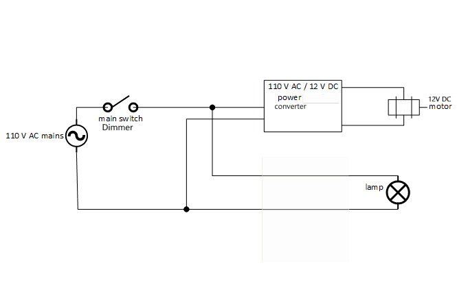

I have a question regarding a light fixture I'm building that also has a motor in it. It has geometric shapes that spin slowly around the light (almost like a mobile) and this is what I'm using the motor for. The light fixture will be attached to the ceiling like any normal light fixture or chandelier and I want to use a light switch on the wall to be able to turn it on and off. The light bulbs will be powered by 110V AC. The 12V Synchronous DC motor will be powered by 12V DC. I am using an Inverter which is 12 Volt DC To 110 Volt AC which will be able to accommodate turning both the motor and bulbs on with a flick of the light switch on the wall.
The question I have is in regards to a dimmer switch. I want to use a dimmer switch to be able to make the lights brighter or dimmer. However, because the motor is also being controlled by the dimmer switch I want to know if this will be a problem and what will happen. Will it slow down the rotation? Will It damage the motor? If it will pose a problem are there any simple solutions or work arounds? I haven't purchased the dimmer switch yet. Is there a certain type that will work with this or a certain type that won't?
Just to clarify why I'm going about it this way. Initially I was just going to use an AC 110 V motor so it would all be on AC. The problem was getting UL approval because of the motor. Because I'm using a 12 V DC motor instead it is kind of a loophole for me so I can get UL approval without all the headaches. Using a 12V DC motor will not be a safety concern in terms of UL certification.
The motor I'm using is a 12V Synchronous DC geared 1 RPM motor. It's just a simple one you can buy on Amazon and I'll post the link to it: https://www.amazon.ca/gp/product/B07YFJR62T/ref=pp...
Also, on a side note I'm not sure what inverter I should use for this project. The choice is between a constant current inverter/driver vs constant voltage inverter/driver. I'm not sure which one to use here.
Any insights would be greatly appreciated. Thanks!

Okay, maybe you could upload a sketch of what you are trying to do? Use the "Attach files" link below the Edit window to upload a PDF or JPEG file with your sketch.
Initially it sounds like your product would be installed in existing 110Vrms areas. If you could get the 110Vrms motor approved easily, the whole fixture would run off of room 110Vrms AC Mains supply. But because using a 12Vdc motor simplifies UL approval, somehow you are turning the room AC Mains 110Vrms into 12Vdc (with that LED driver module?) for the motor.
And were you asking about using an SCR/PWM 110Vrms dimming module to PWM the AC Mains input to that LED driver module? I don't think that would be compatible with that AC/DC converter module. At the very least, there could be some stability issues.
This is all very confusing for me (and likely for others)... Hopefully your sketch will help clarify things. Thanks.

Thanks very much for your informative response. For the most part I think you understand what it is I'm trying to do. I don't want an SCR/PWM module. I don't really care about controlling the motor speed as this is not may intention at all. It's a 1 rpm motor and I'd like it to stay at this speed or if it goes less than 1 rpm I don't mind mind that also.
The main issue here is this light is being installed in a dining room which has a dimmer like most dining rooms have and typically run on 110V AC. The main purpose in the case of this light or likewise any dining room light with a dimmer is to be able to dim the lights or make them brighter. I don't care at all about controlling the motor speed but it just so happens that the light switch connected to this light will have a dimmer (I can get any dimmer though and install whatever I like). I'm worried how the dimmer will affect the motor in this light.
Because it's in a dining room house it's not like I can just run a separate power cord from the motor and plug it into a wall outlet. This would not be aesthetically pleasing or appropriate for a house. I want to know if the 12V DC gear motor (not a synchronous motor) will get damaged here with this setup? If so, is there any solutions to keep this setup and find out a way to do this without damaging the motor. I've attached a diagram of what I'm trying to do. Thanks for looking.
The diagram helps a lot, thanks. So basically you want a 110Vrms/12Vdc converter that is well behaved while the 110Vrms duty cycle is varied by a typical SCR/PWM dimmer switch. Ideally, the 12Vdc output would remain steady over some PWM range, say 100% to 25%, and the 12Vdc would drop to 0Vdc below that to just smoothly stop the motor and mobile motion.
What is the power input spec for the 12Vdc motor? It's probably a pretty low power motor, if all it has to do is turn a suspended mobile sculpture. If it weren't for the UL approval issue, it would be pretty easy to add a rectification stage input to the power converter to store the input energy on a capacitor for the 12Vdc output converter.
But to keep it all easy to submit to UL, you need to find an AC-DC converter module that can handle low input duty cycle 110Vrms power and still maintain the 12Vdc output at your required motor current. Ideally this module would already have a good size input capacitor inside its input rectifier circuit, to hold up the input voltage across the lower duty cycle waveforms. And ideally, the converter would have some smooth shutdown circuit to turn off the output 12Vdc when the input power drops too low.
Have you had any luck looking for such modules? I doubt that the LED driver module that you showed in your earlier link can do all of that.

"So basically you want a 110Vrms/12Vdc converter that is well behaved while the 110Vrms duty cycle is varied by a typical SCR/PWM dimmer switch. Ideally, the 12Vdc output would remain steady over some PWM range, say 100% to 25%, and the 12Vdc would drop to 0Vdc below that to just smoothly stop the motor and mobile motion." Yes, this is correct.
"What is the power input spec for the 12Vdc motor?". 4 Watts
"Have you had any luck looking for such modules?" I have not. I'm not sure how to even go about finding an AC-DC converter module such as this. One of the reasons I chose the LED driver module that I did was because it was the smallest one I could find that would work for me and it is already UL approved which is also what I need. I specifically want something small since I have to incorporate this into the design of the light fixture and I'm kind of hiding it within the fixture.

So if you were designing this whole system from the ground up, you would put an energy storage stage between the 110Vrms input and the switching power supply circuit that generates your 12V. Most off-line switching power supplies will not operate with too low of an input supply of energy, but if you design or choose your power supply to do it, you could have it still supply an output 12Vdc with a low input power waveform PWM % and a low enough output power demand (like your light DC motor load requirement).
But using a large off-line AC-DC power supply to satisfy this requirement will be expensive and overkill, so not likely a good solution for you. Doing it in a custom way like I mentioned would likely be the least expensive way to do it, but I'll have to think about the UL approval issues involved.
Would running two different 110Vrms circuits to your fixture be an option? One would be SCR/PWM controlled for dimming the lights, and the other would be a straight ON/OFF switched circuit to power the motor.

Unfortunately running two 110Vrms circuits isn't an option for me. The intention is that this would be going into already finished homes where the wiring is already finished and the expense of adding another line is not really feasible for most people. I'm trying to come up with another solution for this.
If this is a ceiling fitting then used the existing mains supply and fit a 12v power supply in the cavity. Motor and lights can be varied with readily available 12V wireless controls. Everything would be dead safe and would need no major adaptation of the house wiring.

Then it's just engineering.
Though the really difficult part would be not about circuitry but about the safety and EMI standards, at the end this means you cannot cut corners and has to do all the work and paperwork.
A controller regulates all features, including dimming. Communication from the controller to the ceiling unit, could be wireless, or over the power line.
Power could be delivered to the ceiling unit continuously, or only when required by the controller. EMI radiated by the dimmer would be reduced.

Thanks for your reply. That's a great idea. I was considering putting a wireless dimmer just on the light portion of this and it would be controlled by a remote and would be installed within the ceiling box or within the light fixture itself. Is this what you mean? Just to reiterate the challenge I'm facing is that this is in a finished house and we don't have control with anything before the ceiling box that the light fixture is going to. I realize it makes it more difficult but I can't change the way the house is wired and can't expect the homeowner to incur additional electrical costs and labor to the wiring within there home. I'm trying to find a solution to avoid this.
Well, you only have one option, IMO, and I'm going to close this thread pretty soon because of your constraints. We can help with a lot of questions, but when you overconstrain the problem statement to this level, well, there can be no solution.
You need to find a way to supply 100% duty cycle energy to the fixture when it's turned on, and control the light duty cycle some other way. You cannot fundamentally power your motor mobile with low duty cycle SCR PWM energy unless you invest in the UL approval costs of an energy storage stage.
