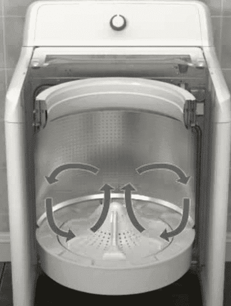

kyphysics said:
This is interesting. In real world/practice, have you ever seen a very dirty piece of clothing (stained and all) - with the top portion not submerged in water - get cleaned in the way you're talking about above?
This is a case where pictures explain better than words. The HE washer circulates the clothes so that all are submerged part of the time.

I see there's a bit of cross purposes here. That's a top loader and the last one of those I had was in the early 70's. No proper tumbling action with a vertical axis so the comments all make sense now.
Ah I see. Unfortunately, this happens over and over again with online conversations. Omission of a single phrase (in this case top-loading) causes some participants to think about the question with a completely different mental model than others. Miscommunication follows and gets amplified and in some cases, heated.
The only cure for that is for everyone to try to be complete and clear in their writing, and to remember that not everyone who reads your post has the same experience background as you (some people have only top loaders, other people only front loaders, still others wash by hand). That advice is easy to say, but hard to accomplish.
As I explained two posts above, I watched the entire cycle and the top portions of my clothes never get submerged. They weren't able to be tumbled for some reason and the tops stayed the tops and the submerged bottom parts stayed the submerged bottom parts.
That sounds like a really duff design. A horizontal axis of rotation takes care of that nonsense.
