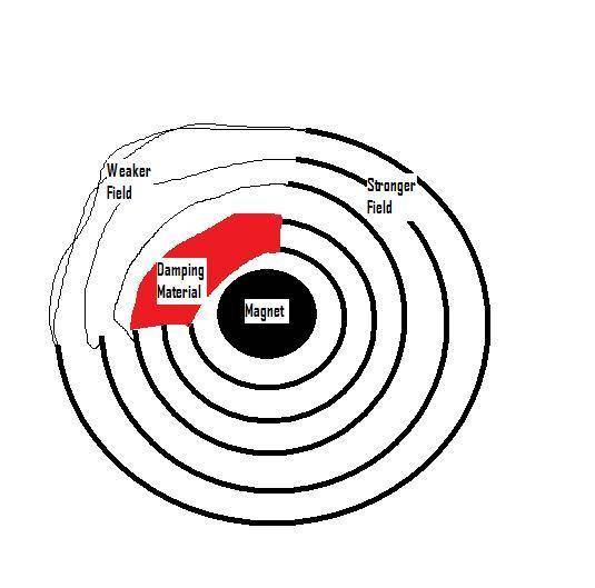

I've been somewhat curious about this for a little while:
Is there a way to obstruct a magnetic field so that it is weaker in one area and stronger than another.
I have attached a picture of what I'm kind of looking for, but also anything that could cause the same effect in terms of focusing the field into one place would be very helpful as well (like would a coiled magnet do this effectively?).

You can reduce the field in a region by applying shielding consisting of sheets of iron (or iron alloys). See the following sites for more information:

Without knowing your desired use, if you are hoping to construct a 'pseudo" magnetic monopole for PMM application, good luck. Shielding won't work, and damping will but requires energy applied thus negating PMM.
Then again, I have no idea what you are eventually after.
If you could explain your application, I might be of some help.
Magnetic field lines emerge from one point in the magnet, and enter another point: they don't form circles around the magnet like you've drawn.
There's a property of field lines that makes them very useful for understanding if a given field condition is possible: remember that you cannot change the entrance and exit points for a given field line at the magnet, but in between, you can reroute the field lines any way you like, provided that two lines never touch each other.

Right, I had also noticed the drawing to be inaccurate, but I ignored it assuming the OP knows about field lines and chose to draw a simplistic(albeit inaccurate) diagram for his question.

The lines are imaginary (but nevertheless useful). One could use different measurement units and get different numbers of lines. (The iron filing lines you see depend on the size of the filings)
