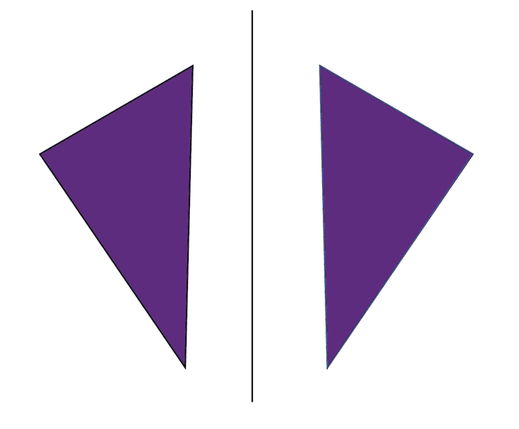

For example if you have a 2 d triangle like the one in the picture:
You can turn it in 3 dimensions 180 degrees in a sense mirroring it and you will get back to the original, but then you have to turn it in 3 dimension in a sense lift it up from the plane and turn it.

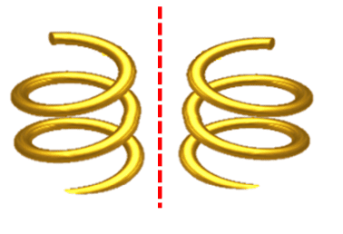

Can you do the same for a helix or not? If you were able to turn it any way you wanted in 3 dimensions as many times as you wanted could you get a left handed screw to become a right handed?

I believe it can't be done in 3D. I don't know how to prove that though. In 4D it's easy.

There are chemical reactions that invert chirality (SN2 reactions are a prominent example), but a chiral molecule (or any chiral shape in Euclidean space) cannot be superimposed onto its mirror image using only rotations and translations. Mathematically, chirality requires that the shape's point group not contain an improper axis of symmetry.
Left handed and right handed helices have the same curvature but have torsions of opposite sign.
Rigid motions of three space preserve curvature and torsion so opposite handed helices cannot be transformed into each other by a rigid motion (a rotation plus a translation).
