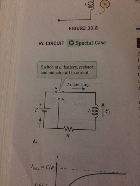

After a switch is left for a for many time constants, it is switched to b. find an expression for the total charge that passes through the resistor in one time constant
dq/dt = I(t)
I(t) = (ε/R)(e^(-tR/l))
so dq = I(t) dt
I know the constant is tau but I can't find that so I am just going to call it v, v = l/R
Q = ∫(ε/R)(e^(-t/v)) dt
Q = (ε/R) ∫(e^(-t/v)) dt
let u = -t/v let du = -1/v dt
-du*V = dt
∫(e^(-t/v)) = -v ∫e^u du
∫e^u = e^u
e^u = e^(-t/v) from t to 0
∫(e^(-t/v)) = ε/r * [ -v * (e^(-t/v) - e) ] = Q(t)
its asking for total charge at one time constant (v)
ε/r * [ -v * (e^(-v/v) - e) ] = Q(v)
ε/r * [ -v * (e^(-1) - e) ] = Q(v)
((εv)/(r)) * [ -(1/e) + e ] = Q(v)
but my book is telling me the answer is
((εv)/(r)) * [ (e-1) / e ] = Q(v)
what am I doing wrong?
What are a and b? Post the circuit diagram.
Textbook diagram of an RL circuit with a battery, switch at a or b, resistor R and inductor L in series, labelled "Switch at a: battery, resistor, and inductor all in circuit"; below, a graph of I against time rising toward Imax = E/R.
  • Textbook diagram of an RL circuit with a battery, switch at a or b, resistor R and inductor L in series, labelled "Switch at a: battery, resistor, and inductor all in circuit"; below, a graph of I against time rising toward Imax = E/R.
robphy said:
When you evaluate the limits, what term is associated with t=0?
Do you mean when I take the integral?
so from
"e^u = e^(-t/v) from t to 0"
you get e^(-t/v) - e^0 = e^(-t/v) - 1
so wait this isn't what I wrote in my OP :S damnit
Thanks so much. I'm not sure why I'm making such simple mistakes but I feel like accelerating off a cliff rn.
