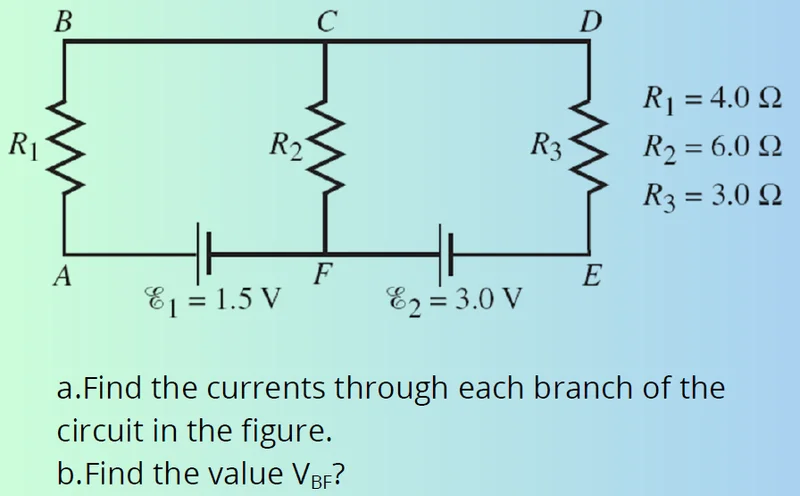

Finding potential difference in a circuit

Please see below
Kirchhoff Law
Circuit schematic with resistors R1 = 4.0 Ω (branch B to A), R2 = 6.0 Ω (branch C to F), R3 = 3.0 Ω (branch D to E), EMFs E1 = 1.5 V and E2 = 3.0 V in the bottom branches, and nodes A, B, C, D, E, F.
I have found part (a):
current on the left is 7/12 A from A to B
current on the middle is 5/36 A from F to C
current on the right is 13/18 A from D to E
For part (b), what is the meaning of VBF? Is it VB - VF or VF - VB?
My attempt is:
VBF = I1 x R1 - ε1 = 7/12 x 4 - 1.5 = 5/6 V
Is it correct?
Thanks

VBF is the voltage drop from point B to point F and yes, that's correct.

I am unsure of what to say here. There are those who will tell you that Vbf is equivalent to Vb - Vf, and there are those who will tell you that Vbf is equivalent to Vf - Vb. If your choice is Vbf=Vf-Vb, your calculations are correct. The points B and C are at the same potential, so you can check your result by calculating the potential difference across the resistor R2, which is Vcf. It must be the same as the potential difference Vbf. Points B and D are also at the same potential, so Vbf must be equal to Vdf too.
Thank you very much for the explanation Rap and Gavran
