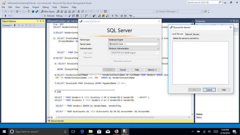

Hi All,
I had to reinstall my SQL Server and I a having trouble finding the database engine which is the local host. Please see screenshots. Any ideas? Thanks.

Did you try using the actual tcpip address of your host or the 127.0.0.1 to test that it works ?
Did you try searching on google to see if others had the same problem? It may well be a product issue.
Review your install confit stuff to see you have to place anything in the Microsoft Windows registry ?

Can you start SQL server configuration manager? You probably need the check if the sql server browser service running. The TCP/IP network protocol should be enabled. Look if what the name of the instance of SQL server is, and don't browse, but connect to COMPUTERNAME\INSTANCENAME. Look at https://docs.microsoft.com/en-us/sq...-connecting-to-the-sql-server-database-engine See the steps under "testing a local connection"
If that doesn't work look in the windows eventlog if there were any errors during startup of sql server (restart services with configuration manager if necessary).

Thanks all, I just uninstalled and I am re installing at the moment.
