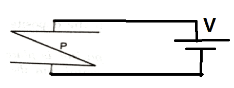

A thin metal plate P is inserted between the plates of a parallel plate capacitor of capacitance C in such a way that its edges touch the two plates. The capacitance now becomes (a) 0 (b) infinity.
$$ C=\frac Q V$$
Because of the plate P, the capacitor becomes a piece of conductor. It contains zero net charge and has 0 potential difference. Hence, the capacitance is ## \frac 0 0 # # that is undefined.
The capacitance of a capacitor is defined as its capacity to store charge when a potential difference is applied across the plates. Here, the plates cannot store net charge. So the net stored charge is zero. Hence, it's capacitance should be zero.

A capacitor is defined as two separate conductors separated in space such that if one transfers charge ##Q## from one conductor to the other, a potential difference ##V## will exist between the two. The capacitance is defined by the equation you quoted and is a geometrical property. It depends on the shape and configuration of the two conductors, not on whether there is charge ##+Q## on one and ##-Q## on the other. An uncharged capacitor still has capacitance.
So your justification that capacitance goes to zero because the modified parallel plate capacitor does not store charge is incorrect. You can always put charge on a conductor in which case there will be a capacitance with the "other conductor" being at infinity. Then the charge you put on this conductor divided by the potential difference between it and infinity is the capacitance.
In view of all this, it appears that neither of the given choices is correct. This does not look like a well crafted problem to me. Is this in a textbook?

I am asked to find the capacitance of the parallel plate capacitor when a metallic plate P is inserted.
So, I put a battery across the two terminal and calculate C. $$ C=\frac Q V $$
Now, Q = 0, but V, too, is 0 ideally and close to 0 practically. So, the capacitance of the parallel plate capacitor now becomes 0.

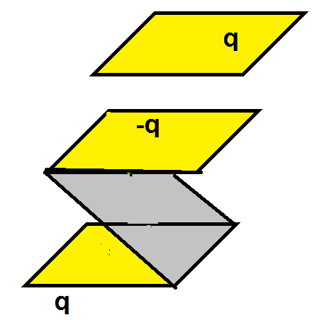

I have got another solution for this.
I put a metal plate with charge q above the capacitor.
Due to induction, the upper plate gets charge -q and the below plate gets charge q while the potential difference between the plates i.e. V is 0.
Hence, ## C = \frac q V = \frac q 0 = \infty ##.

You seem to labor under the impression that without stored charge and potential difference a capacitor does not have capacitance. That is not the case. As stated earlier, capacitance is a geometric property that does not depend on whether there is a charge on the capacitor or a potential difference between the conductors forming the capacitor. Capacitance is like mass or moment of inertia. An object does not need to accelerate in order to have mass or rotate in order to have moment of inertia.
For example, the capacitance of a parallel plate capacitor is (approximately) ##C=\frac{\epsilon_0 A}{d}## and there is no ##Q## or ##V## in the expression. However, to get that expression one has to perform a thought experiment that can be found in any introductory textbook.
  1. Charge ##Q## is removed from one conductor forming the capacitor and placed on the other.
  2. The potential difference ##V## is measured or calculated between the two conductors.
  3. The capacitance is the ratio ##Q/V##.
This cannot happen with the "Z"-shaped conductor that you have. If you start with no charge on it and move ##+Q## from the top of the "Z" to the bottom, you will create a potential difference between top and bottom and the charge will go back where it came from. However, the "Z"-shaped piece and the other plate above it do form a capacitor and you can find its capacitance using the procedure outlined above. Or you can consider the "Z"-shaped alone, bring some charge from infinity and put it on then find the capacitance relative to infinity as mentioned earlier.

I understood that this is what my book meant and after the insertion of the metal plate P, the parallel plate capacitor becomes a "z" shape piece of conductor and its capacitance has to be found assuming its other part at infinity.
