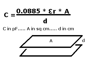

Hello ramonegumpert,
A home-made capacitor to rival a supercapacitor? Here I begin to wonder if you might just be pulling my leg. In case you are being serious here, the formula for a parallel capacitance is
C = ε0*εr*A/d
C is the capacitance, in farads;
A is the area of overlap of the two plates, in square metres;
εr is the relative permittivity aka dielectric constant of the material between the plates
ε0 is the permittivity of free space (ε0 ≈ 8.854×10−12 Fm−1); and
d is the separation between the plates, in metres.
Suppose you built a capacitor with 50cm diameter round plates, with 1mm thick polythene (εr = 2.3) as an insulator.
Can you work out its capacitance from the formula and the numbers I've given above?
I found a version of that formula that gives the units in a more familiar way.
Gives the same result as the one above.
https://www.physicsforums.com/attachment.php?attachmentid=22999&d=1263260214
To put the result into familiar terms, it would take 250 million circular plate capacitors as above to make one Farad.
Sad but true, SI or otherwise it's still about 4nF. I think those home-made capacitors may be meant to allow operation at very high voltages at a reasonable cost. Perhaps they would be used as an alternative to Leyden Jars, e.g. with an electrostatic generator like a Wimshurst.
It may be worth saying that such things can be horribly dangerous: although everyday static shocks are often fairly mild, even a modest capacitance charged up to a high voltage can kill.
