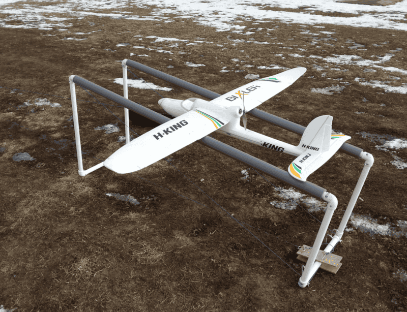

Endurance flight is about keeping weight as low as possible, so it is probably much wiser to use longer runway (or start from a catapult, even DIY style) than to make model heavier.

Doable, but not trivial. I too would rather recommend a catapult or such as @Borek already suggested.
