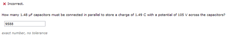

How many 1.48 µF capacitors must be connected in parallel to store a charge of 1.49 C with a potential of 105 V across the capacitors?

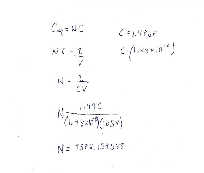

Refer to the attempt at a solution.
Also, for the answer exact number, no tolerance. I tried just rounding the number but that didn't work. I not sure. Does it mean I should round the answer up to 9589?
Hi McAfee! :smile:
(i haven't checked your figures)

yes, of course
you can't buy 0.16 of a capacitor, can you? :biggrin:

You are right. Thanks for the help.
