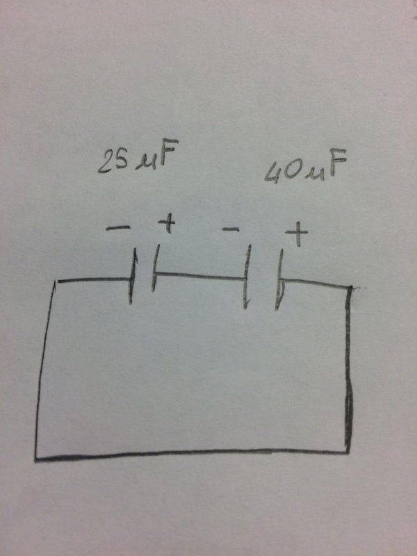

In my opinion the voltage across C1 remains 50V, across C2 remains 50V. By the way these capacitances are in microfarad (not in millifarad).

Why do you say it is still 50V. If that is true then the charges on each respective capacitor would have to remain as they were before being connected.

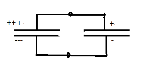

Note that they can also be viewed as being in parallel, each capacitor shares a common node or point.

Don't disengage. The circuit is both series and parallel. When viewed as parallel the two capacitors must have the same voltage. The charges on the shared connects must distribute in such a way as to fulfill this condition.

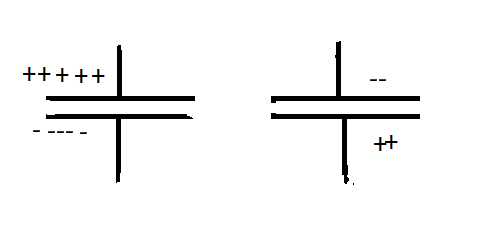

before the capacitors are connected they are charge to the same voltage. Because they have different capacitance the charges are different.

The capacitors are now connected so the positive side of one is connected to the negative side of the other to form a completed circuit.
The charges redistribute. (Note that the sum of the charges on the plates when connected must equal the sum of the charges on the separated plates before being connected) Even though there is nothing else connected to the capacitors at the dots you should recognize that they are in parallel which means they must have the same potential drop across them. Thus the charges on each capacitor must be different.
Note also that this pair of capacitor can be replace by a single one whose capacitance is the sum of the two capacitors with a charge on it equal to the sum of the charges on each capacitor.
