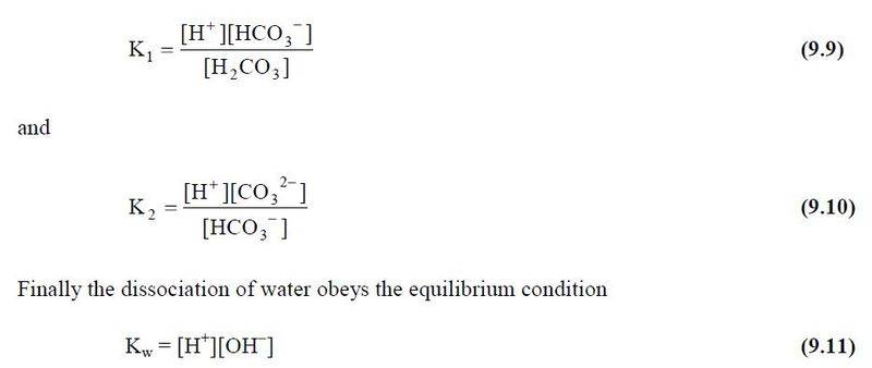

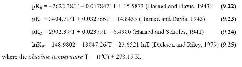

Ok, think I'm nearly there with this. I can assume an ideal solution and use the following:
Therefore I can get K0,K1,K2 AND Kw by inserting the above into:
The next part is where I'm a little confused, I want to use these:
To calculate these:
This is good, I can measure the pH and get [H+] and I know the K values by calculating from the above BUT 1. how did they get 9.36 from 9.33-9.35? 2. What is CT? 3. I still see 2 unknowns in 9.36 namely CT and [HCO3].

CT is total concentration of all forms (also known as the analytical concentration):
[tex]C_T = [H_2CO_3] + [HCO_3^-] + [CO_3^{2-}][/tex]
Unfortunately that's something you need to know/measure (but in most applications total concentrations of the acid involved is much easier to control/determine than every ion separately). What I was trying to tell you was that you don't need to measure everything, there is a set of equations describing the equilibrium, so it is enough to know some parameters to be able to calculate everything else as well.
