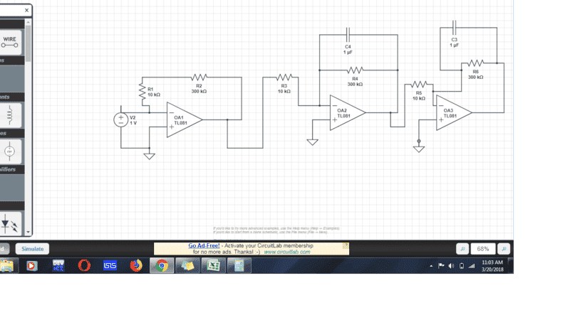

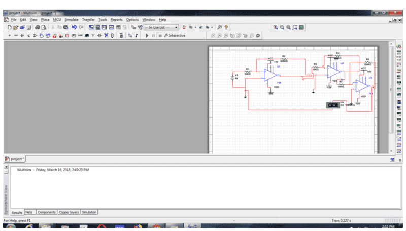

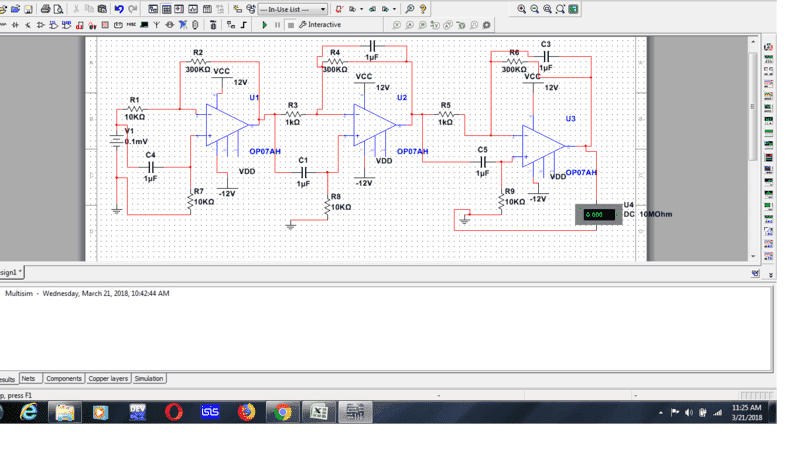

1. Homework Statement
I am using three-stage cascading amplifier, I used resistors of 10K and 300K with the input voltage of 1V. My aim is to get 30 for each stage and calculated bandwidth is around 33.33KHz. Now, when I am simulating at the end of the third amplifier I am getting the output of 15V which I measured in voltmeter. Is this the right method or should I need capacitors in this? Help me out
I have attached my file below
I have a question, Output coming from two stages would saturate the third op-amp or it produces the output
It depends on the properties of the op-amp and the power supply. Some op-amps will only swing to within 3V of the supply rails. The calculated output is -24V so it might saturate if the power supply is less than about +/- 27V.
Edit: This post refers to the circuit in the original thread which also contained three op-amps. I can't see the new circuit in this thread clearly enough to comment. eg It might saturate for other reasons.
Please can you post a clearer image.
All three stages have a gain of 30? There are several problems with that...
First problem is that 1V*30*30*30 = 27,000V so the output will saturate unless the power supplies are >27,000V !
You may also need to read up on DC Offset. Op-amps are not ideal. They can produce a small DC output voltage even with zero input. This can matter at very high gain because it's also amplified by the next stage. Typically a high pass filter capacitor is needed between each stage to block the DC offset but allow the wanted signal through.
PS: Is your input really 1V? Why do you wish to amplify it?

Thanks for the help, I am using small voltages to the amplifier so that it can amplify the voltages better. If I reduce the voltage, I cannot get the desired gain.
PS: What should be my voltage to get the desired gain? What specification of high pass filter capacitor should I use in my circuit?
I am uploading my design here

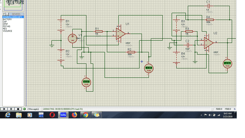

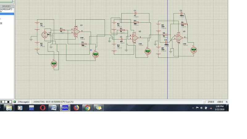

CWatters said:
You will also need to make the input (V1) an AC source.
But, I simulated in Proteus. At the third stage, it's taking more voltage up to 230V. I am uploading the circuit with all the improvements made. please check.
Can you post a better image? I cannot read the circuit values or pin numbers.
Can you zoom in and make two screen shots (left and right)?

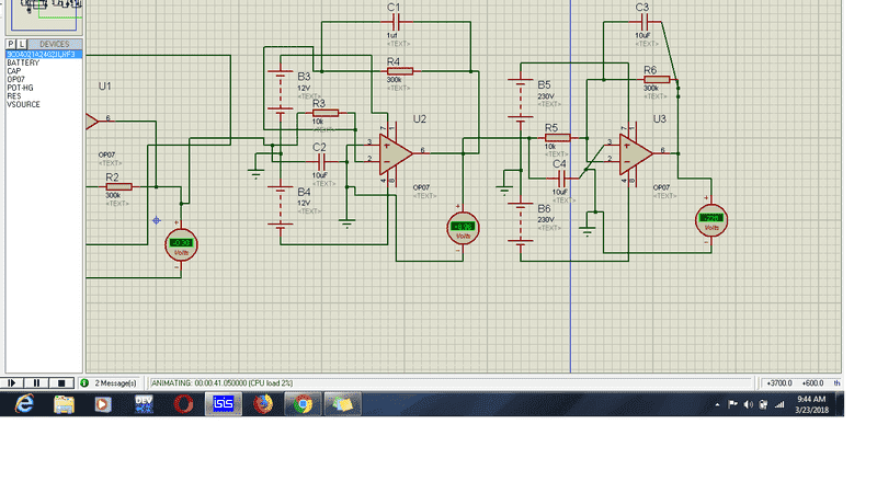

OK, I have done two parts and I am uploading. Please refer the third stage, where it's taking 230V and displaying 228V. Here, the question is op-amp taking 230V and displaying the output. Does it make sense?

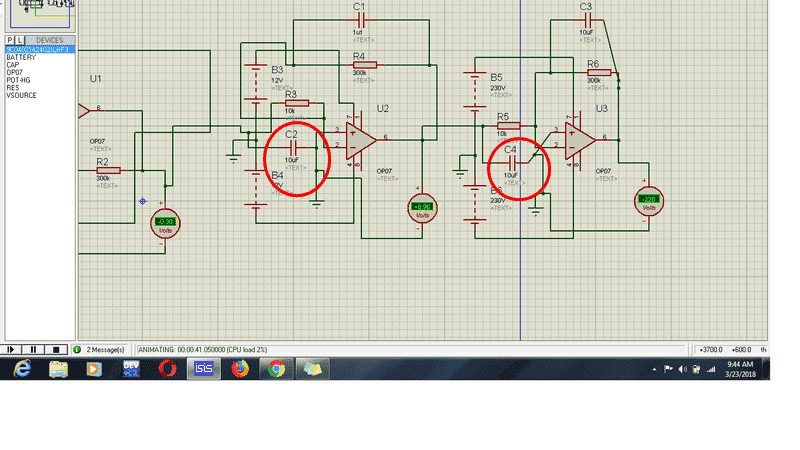

You also wrote...
jSwathi said:
1) Input voltage: 0.1mV
2) Output voltage: 2.7V
3)Total gain required:2.7/(0.1*10^-3)=27000
4) I am using three stages each of gain of 30
The input V1 on your circuit is 10mV not 0.1mV
10mV * 27000 = 270V The power supply is 230V so the output of stage 3 will saturate at about 230V.
This circuit would not work if you built it. The maximum power supply voltage for the OP07 is +/- 18V. If you used 230V it will fail. It would also be dangerous.
I do not understand why you have these two capacitors...

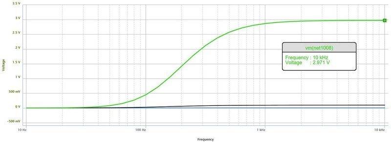

Here is my version of the circuit. My version amplifies AC only. If your source V1 is DC you need a different circuit.
I have not shown the power supply.
1) Input voltage: 0.1mV AC
2) Output voltage: 2.7V AC
The gain of the first stage is set by R2 and R1. Stage 2 and 3 are the same.
Capacitor C1 and R3 form a "high pass" circuit. This has a "cut-off frequency" of about 160Hz. Same for C2,R6 and C3,R9. This blocks any DC offset.
If you need a different cut-off frequency you can change C1, C2 and C3.
See also http://sim.okawa-denshi.jp/en/CRtool.php
Here is the output from the simulator. It is the frequency response for the output of stage 3 (Net1008)..
The output (above the cut off frequency) is 2.9V
