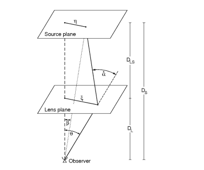

##\vec \theta## is an angular position on the flat approximation of the sky, I've attached an image to illustrate it. A common example in the literature is to use the heaviside step function as the weight function, which I think just defines a sharp cutoff of the image along an isophote.

Ok, but can you shed any light on the d2θ? I would have understood dθ as just the usual integration notation. I suspect it has something to do with the fact that we really want to integrate over the annulus rdrdφ, where r is proportional to θ and φ runs from 0 to 2π, but that would give something like θdθ, not d2θ.
