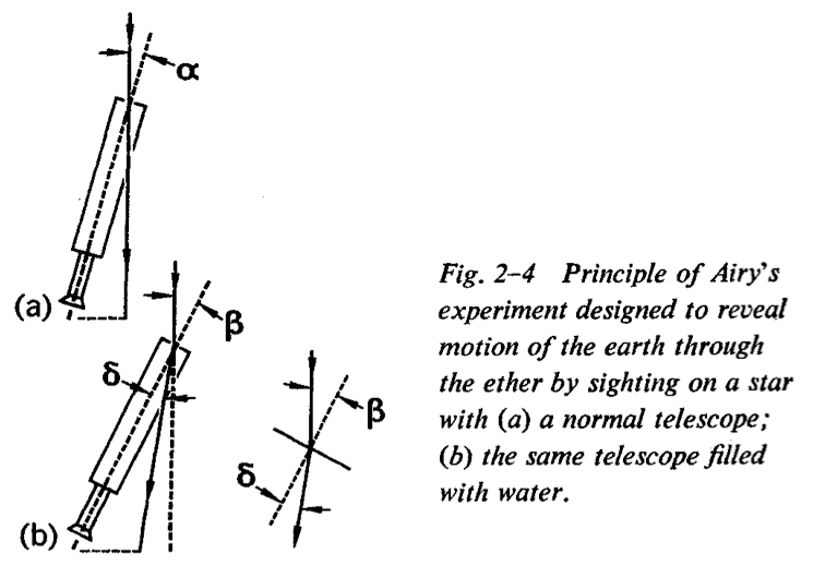

- There is a small section in the book "Special Relativity" by Anthony Philip French that has me bewildered for quite a few hours now.
I'd like to understand how to obtain equation (2) below.
**My question is how to obtain (2)?**

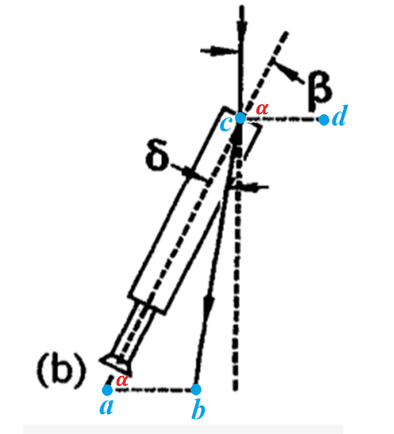

##\beta## is the angle shown in figure 2-4b above.
This angle is the aberration angle for an incidence angle of ##90^{\circ}##.
We see a solid line showing light inciding at this ##90^{\circ}## angle with the horizontal and being refracted.
There is also a dotted line passing straight through the middle of the telescope. Whatever the position of the telescope, if we are in frame ##S'##and if light hits the telescope at this right angle (relative to the border of the telescope) the light will not bend.
However, though we can vary the position of the telescope, the angle at which light arrives at the telescope depends on the speeds of light and earth. In particular, if we measure the angle from the vertical, then (3) and (4) tell us what this angle is. This is what ##\beta## is.
In particular, if ##\theta=90^{\circ}##, then
$$\beta=\theta-\alpha=\frac{v_{S',S}}{c/n_{\text{water}}}\tag{5}$$
Snell's law tells us that
$$n_{\text{air}}\sin{\beta}=n_{\text{water}}\sin{\delta}\tag{6}$$
$$n_{\text{water}}=n_{\text{air}}\frac{\sin{\beta}}{\sin{\delta}}\approx \frac{\beta}{\delta}$$
The book says that the condition for centering the star's image in the telescope is (2), which I repeat here
$$\delta\approx\frac{v}{c/n}=\frac{nv}{c}\tag{2}$$
At this point, I am going to stop, because I have spent three hours formulating this post and I don't know how to proceed further. That is, I have written some equations above, but I can not reconcile them with (2).
Suppose that a telescope has been aimed at a star whose true direction
is at ##90^{\circ}## to the plane of the earth's orbit. Let the unknown aberration angle > be a [Fig. 2-4(a)] and let the unknown speed of
the earth through the ether be ##v##. Now imagine that the whole tube of
the telescope is filled with water, of refractive index ##n##. Since
light travels more slowly in water than in air or vacuum, the time for
the light to travel down the length of the telescope tube will be
lengthened—by the factor ##n##. One might expect, therefore, that to
keep the star's image in the center of the field of view one would have to till the telescope further, to some new aberration angle
##\beta##, and that the amount of this adjustment could be used to find
the speed $v$. At first glance one might think that the angle ##\beta##
would be just ##nv/c##, but in analyzing this experiment one must
remember that, because the objective lens of the telescope now has air
on one side and water on the other, the light rays entering the
telescope are bent toward the axis of the instrument, as indicated in Fig. 2-4(b). Inside the telescope we would expect the rays to travel at an angle ##\delta## to the axis such that
$$n=\frac{\sin{\beta}}{\sin{\delta}}\approx\frac{\beta}{\delta}\tag{1}$$
Since the light is traveling downward with speed ##c/n##, and the telescope is moving sideways at speed ##v##, the condition for centering
