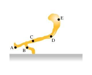

And this center of mass problem confuses me.
Would the base of the irregular object be B, so the center of mass should be C since it is directly over it?
The abstract sculpture shown in the figure can be placed on a horizontal surface without tipping over. Different parts of the sculpture may be hollow or solid, or made of different materials, but the artist isn't revealing any such information.
Five locations labeled A through E are indicated on the diagram. Which of these, if any, is a possible location of the object's center of mass?
A
B
C
D
E
cannot be determined

Your figure on the CM question makes no sense to me, so I have nothing to tell you there.
