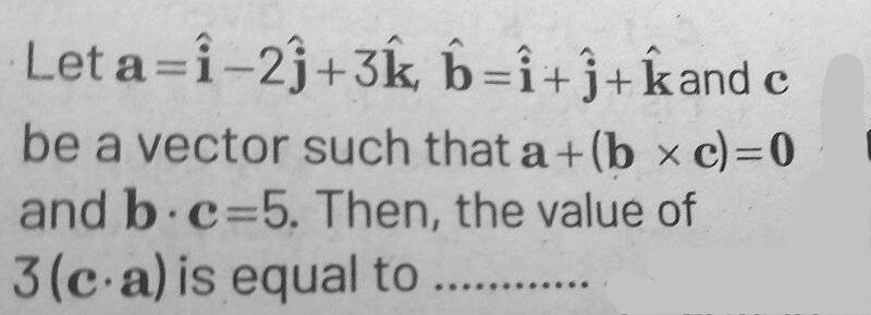

##a=\hat i-2\hat j+3\hat k## and ##b=\hat i+\hat j+\hat k##
##c## is a vector such that ##a+(b\times c)=0## and ##b.c=5##
Find ##3(c.a)##

$$a+(b\times c)=0\implies a=-(b\times c)=(c\times b)$$
Then
$$3(c.a)=3(c.(c\times b))=0$$
Since cross product of vectors is perpendicular to both vectors and dot product of perpendicular vectors is zero.
Now here's the problem, correct answer given is 10. But how do I get that?Why is my answer wrong?

I crack my head to find why your method is wrong, but I find indeed 10 IF I use another method where I take the triple cross product ##a\times(b\times c)=0## (you can deduce this equation by taking the cross product with ##a## of the given equation.
Well the problem statement has a contradiction, it gives as ##a## clearly different than the zero vector, but it also gives that ##a+(b\times c)=0## from which you can deduce that either a is zero or that a is perpendicular to b (and perpendicular to c), neither can hold according to what is given for a and b.

There is an obvious self-contraction in the problem statement. From ##\vec a + \vec b \times \vec c = 0## it is necessary that ##\vec a \perp \vec b## but the given ##\vec a## and ##\vec b## are not perpendicular by virtue of ##\vec a\cdot \vec b = 1-2+3 = 2 \neq 0##.

And this was a 'Previous Year Question' in an exam. They tried too hard to make it difficult.

This solution that gives 10.
It is not the first and not the last time someone makes a mistake when formulating an exam.
