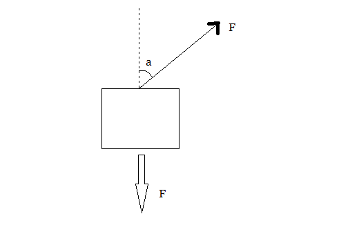

Think about this:
The force equal to the weight is acting at an angle,so it would create a resultant force and accelerate slightly down.Won't it?

No other force needed. The basket flies out and upwards until the vertical component of the tension in the cable is equal to the weight.
adjacent said:
I know.but this is due to a horizontal force.
The acceleration is due to horizontal net force.
Think about this:
No. That tension force which acts at an angle is not equal to the weight--it's magnitude is greater than the weight.
Assuming it moves in a horizontal circle at constant speed, the net force will be horizontal.

The vertical component of the tension F must be equal to the force due to gravity.
Horizontally...
The horizontal component of the tension F must provide the centripetal force required to make it move in a circle.
The actual tension force F is the sum of these two components.
