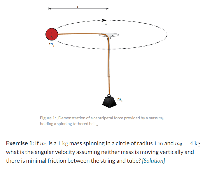

@Mohamad To visualize this better, imagine m2 is such that m1 is on a circular path, and then you increase m2 suddenly.

What do you think happens if you suddenly increase m2 in post #10?
A.T. said:
You want to find the path, not assume it.
A.T. F=mrω2, m is consntant, r could not increase, so I think ω should increase.
Do I hava a misconception?
P.S. a is perpendicular to v so I used that formula.

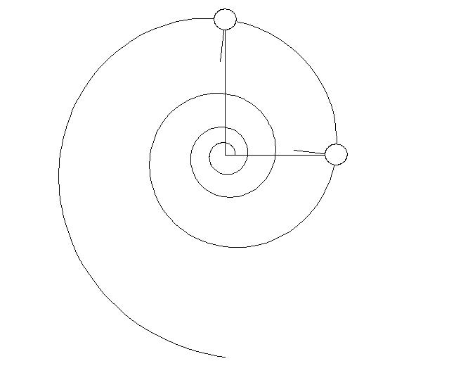

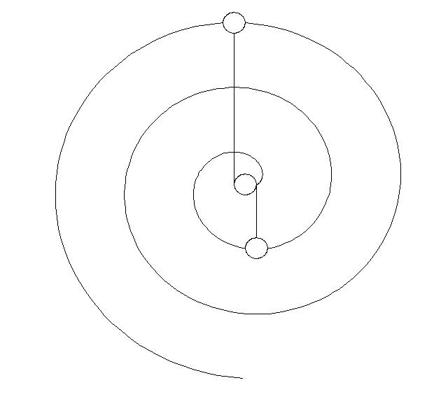

I have images for the two cases mentioned above. If the force is towards a fixed point, such as the string going through a hole, then the energy increases as the string is pulled downwards through the hole, and the energy decreases if the string is allowed to move upwards through the hole. Angular momentum is conserved. in the "hole" image below, the short lines show the direction of force, which is not perpendicular to the path (so the energy and speed change).
If the string wraps around a post, the force is always centripetal (perpendicular to current velocity), energy remains constant, and angular momentum is not conserved unless you include the momentum of whatever the post is attached to (such as eventually the earth), since there's a torque on the post.
