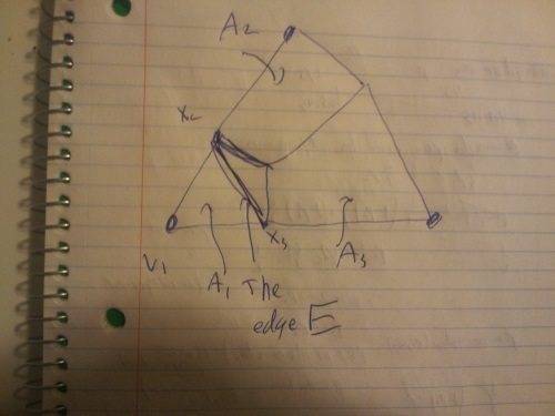

If I understand your construction of E correctly it won't work, because E can be covered by A1, unlike F1 so the A2 and A3 may not intersect. I have attached a picture (I think, we'll see if I did it right) of what I think is a counterexample, if it's wrong let me know!

Office_Shredder said:
I realized that my original protest about your three triangles was not correct (I misunderstood what triangles were being constructed), although I have no idea whether they'll do what you want them to do.
Crap, you're right. My argument for the original edge only worked because we knew that one of the ##A_i##'s had null intersection with it. That isn't the case for ##E##, as you pointed out.
OK, back to the drawing board!

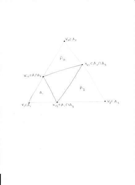

Here's my attempt to attach a picture of what I think has been established so far.
* ##A_1## contains the triangle defined by ##v_1##, ##x_{13}##, and ##x_{12}##, including vertices and edges
* ##A_2## contains the triangle defined by ##v_2##, ##x_{12}##, and ##x_{23}##, including vertices and edges
* ##A_3## contains the triangle defined by ##v_3##, ##x_{13}##, and ##x_{23}##, including vertices and edges
* the segment ##[v_3, x_{13})## contains only points of ##A_3##
* the segment ##[v_1, x_{13})## contains only points of ##A_1##
* the segment ##[v_1, x_{12})## contains only points of ##A_1##
* the segment ##[v_2, x_{12})## contains only points of ##A_2##
* the segment ##[v_2, x_{23})## contains only points of ##A_2##
* the segment ##[v_3, x_{23})## contains only points of ##A_3##

I agree that everything in that post is correct.

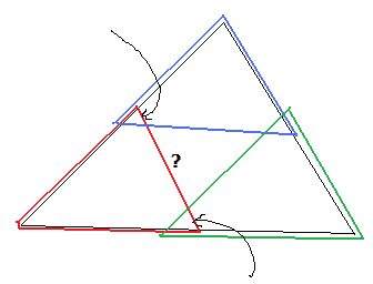

x12 can be extended to a line segment on the edge where A1 and A2 intersect. Proof by contradiction: Suppose they would intersect at a single point only: Then their whole intersection is just this point (as they are convex), and x12 would be the boundary of ##A_1 \cup A_2##. A3 cannot include x12, but would have to include points arbitrarily close to this -> it would not be closed, contradiction.
This allows to extend the triangles a bit, and ##A_1 \cap A_2## is a closed, convex set with non-empty interior. The same is true for the other two sides, of course.
Now consider the set ##((\partial A_1) \cap A_2) \cup ((\partial A_1) \cap A_3)## as subset of ##\partial A_1##, the boundary of A1 (marked with the two arrows in the attachment). If the set is connected, we are done (the existence of a point in all Ai is then equivalent to the proof that a point x12 exists).
If the set is not connected, there has to be some point in between which is at the boundary of A1, but neither A2 nor A3 cover it (marked with a question mark). This is a boundary of ##A_1 \cup A_2 \cup A_3## in the interior of the triangle, which violates the condition that the union covers the whole triangle.
Alternatively: There is at least one point of ##\partial A_1 and \partial A_2## that is also in ##\partial (A_1 \cup A_2)## (not sure how to prove this). If this point is in A_3, we are done, otherwise it is a boundary of ##A_1 \cup A_2 \cup A_3## and we get the same contradiction as above.

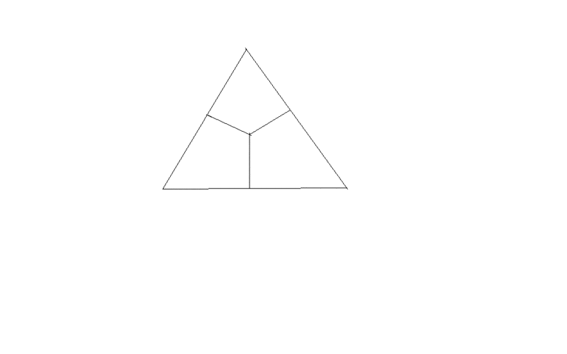

I think we can replace the triangle by an arbitrary convex shape, where we divide the boundary in three regions that get the conditions the edges had in the original problem.
Reading over my earlier argument, I think I am persuaded that ##A_1## and ##A_2## can have more than one point of intersection (hence a segment of nonzero length) on the side formed by ##v_1## and ##v_2##. But I'm not persuaded that they must do so. What precludes the configuration in the attached figure?
Hmm right, I forgot that case.
I think the following argument still holds. The boundary of A1 is connected, so either the two parts are connected and therefore the whole boundary (with at least one common point) or the three sets do not cover the whole triangle.
Nice work mfb, I agree that that works and doesn't require having extra intersection on the boundaries of the triangle.
