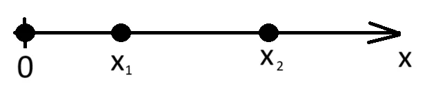

microdosemishief
Change in displacement
Assuming initial displacement is zero, if x = v₁(t) + ½a(t)², why isnt Δx = x2-x1 = (v₁(t2) + ½a(t2)²) - (v₁(t1) + ½a(t1)²) = v₁(t₂ - t₁) + ½a(t₂² - t₁²)
Why is it instead v₁(t₂ - t₁) + ½a(t₂ - t₁)²

The two calculations have a different initial velocity. Your initial formula should be:
$$x = (v_0(t_2) + \frac 1 2 at_2^2) - (v_0(t_1) + \frac 1 2 at_1^2)$$And you also have$$v_1 = v_0+ at_1$$If you use those, you'll see that everything works out with ##v_0## in one case and ##v_1## in the other.

It seems that besides the confusion between position and displacement, there is also some confusion about the positions of the object. My understanding is that there are three positions, ##x_o=0##, ##x_1##, and ##x_2##.

Just to tidy this up. One way to do this formally is to write the position ##x(t)## at any time ##t## then write expressions for the position at specific times 1 and 2 and subtract. It is implicitly understood that time ##t=0## is when motions starts, i.e. the clock starts when the object starts moving. Also, numerical subscripts denote values of quantities at specific times, e.g. ##v_0## is the velocity when the motion (and the clock) starts, ##v_1## is the velocity when the clock reads ##t_1##, etc. Then,
##x(t)=x_0+v_0t+\frac{1}{2}at^2##
##x_1=x_0+v_0t_1+\frac{1}{2}at_1^2##
##x_2=x_0+v_0t_2+\frac{1}{2}at_2^2##
Thus, the displacement from clock time ##t_1## to clock time ##t_2## is $$\Delta x=x_2-x_1=v_0(t_2-t_1)+\frac{1}{2}a\left(t_2^2-t_1^2\right).$$ A second way to do this formally is to start a second clock when the object is at position ##x_1## and has velocity ##v_1##. This clock reads time ##\tau.## The position is, of course, relative to the same origin and is written as
##x(\tau)=x_1+v_1\tau+\frac{1}{2}a\tau^2.## Clearly, the second clock runs behind the first and the times displayed by the clocks are related by ##\tau=t-t_1##. The object reaches ##x_2## at time ##\tau_2=t_2-t_1## so that
$$\begin{align} & x(\tau_2)=x_2=x_1+v_1\tau_2+\frac{1}{2}a\tau_2^2 \nonumber \\
&\implies x_2-x_1=\Delta x=v_1(t_2-t_1)+\frac{1}{2}a\left(t_2-t_1\right)^2.
\end{align}$$ The expressions for the displacement derived by the two methods are the same. This can be verified by substituting ##v_1=v_0+at_1## in equation (1).
